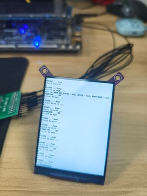

Problem Description
I am using STM32MP257DAK3 with two different MIPI-DSI LCD panels:
  1. Panel A: MIPI-DSI 4 lanes
    → Works correctly in U-Boot using bmp display
  2. Panel B: MIPI-DSI 1 lane
    → Does NOT work in U-Boot using bmp display
According to the STM32MP25 reference manual, the DSI_PCONFR register supports lane configuration from 1 to 4 lanes.
Therefore, I expect DSI 1-lane mode to be supported by hardware.
However, in U-Boot, the 1-lane panel does not display anything.

  • The issue is only observed in U-Boot stage when using bmp display.
  • No DSI error is printed in U-Boot console.
  • The DSI PHY and clock configuration are shared between both panels.

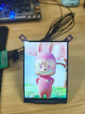

SullyNiu
Answer
Yes, the U-Boot DSI driver (drivers/video/stm32/stm32_dsi.c) officially supports MIPI-DSI 1-lane mode.
I have successfully brought up a MIPI-DSI 1-lane panel in U-Boot on STM32MP25.
After verification:
  • The DSI host is correctly configured to 1 data lane
  • No hard-coded 4-lane limitation exists in the current U-Boot implementation
  • The issue was not a BSP limitation or known issue
The U-Boot DSI driver works as expected for both 1-lane and 4-lane panels, provided that:
  • Device tree configuration is correct
  • Panel initialization sequence and timing parameters match the panel datasheet

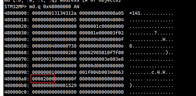

Ticket Update – Additional Debug Information
I have performed additional debugging in U-Boot by directly reading the DSI registers.
  • Register DSI_PCONFR at address 0x480000A4
  • Value read: 0x00002000
According to the STM32MP25 reference manual, this value corresponds to 1 data lane configuration.
