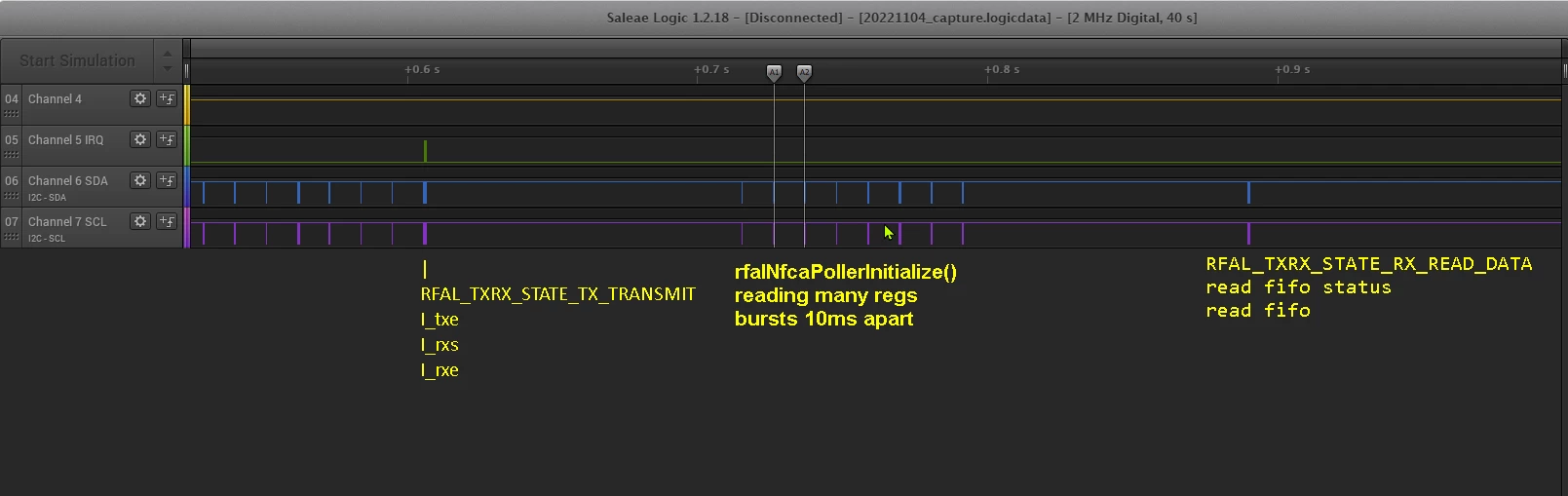

I'm using an ST MCU (STM32F765VGT6) on a custom board, wired to an X-NUCLEO-NFC06A1 communicating via I2C. I've integrated the RFAL library into an existing codebase. I've taken elements of the Disco demo code into our codebase, to exercise the RFAL. (It is based on the PollingTagDetect example, demo_polling.c, from STM32CubeExpansion_NFC6_V1.1.0)
I am able to detect a tag, but the UID is returning as blank. I'm not seeing any I2C traffic on the Saleae analyzer that looks like the ID, so I don't think it is being retrieved from the reader. The code isn't breaking anywhere that seems to write to nfcId1, but it's a little hard to track down which variable it's actually stored in. Can you point me to where in the RFAL library you'd expect the nfcId1 variable to be stored for a NFCA type 2 tag?

Please analyze/debug the unexpected sequence as per this image:
0693W00000WI6BdQAL.pngThe question is how does it come to this unexpected call to rfalNfcaPollerInitialize().
I am suspecting that you are calling rfalNfcWorker() not often enough and some timer signals a fundamental problem.
Best Regards, Ulysses

Ulysses HERNIOSUS
October 21, 2022
Hi Katie,
in the end this is done through calls to rfalISO14443AStartTransceiveAnticollisionFrame().
Symptoms like you are explaining here may be caused by insufficient protection of the I2C calls from both main and interrupt level.
Please check those and if you find nothing then it would be beneficial if you can share logic analyzer traces (I2C + INT pin) to see what is going on.

Ulysses HERNIOSUS
November 2, 2022
I saw some glitches on INT pin and enabled the glitch filter (1us). The last interrupts happening indicate I_rxs,I_rxe @7.138sec from the chip, so part of the UID is received, then some other I2C slave is addressed (addr 0x90) followed by clean-up of the transceive but no reading of FIFO data).
I suspect long delays in your code and software going into error handling despite interrupts happending correctly (could also be related to MCU timers).

Ulysses HERNIOSUS
November 7, 2022
the 2 bytes is the ATQA (44 00 - answer to WUPA) which does not carry UID bytes.
I find in the trace a place where part of the UID is read (the first cascade level (response to 93-20):
0693W00000WHZIRQA5.pngThe reception of this UID bytes is happening at an unexpected place - software seems to have already advanced to somewhere else as it was doing multiple register accesses since the I_rxs. Also after that it does not move on to second cascade level (eg. sending 95 -20)
How does your I2C driver work? Any chance of out of order executions or dropped I2C requests?
Also the trace is hard to follow due to crosstalk from SCL onto SDA (Here it should read as A0 - 5A - A1- 10 - 00 00 00 (I_rxe), which appears after enabling the glitch filter on SCL (1sampe).
0693W00000WHZGmQAP.pngAnd last tip: Saleae V2 software supports better searching in frames, etc instead of only looking at single bytes.
Ulysses HERNIOSUS
November 8, 2022
Addendum,
the register settings in between I_rxe and FIFO handling could also be caused by additional RFAL calls in between - rfalGetTransceiveStatus() not yet signaling done, but calling RFAL APIs before again calling rfalWorker(). Does your software do any such? Maybe you put some logs there to follow the flow of RFAL calls from your application layer.
