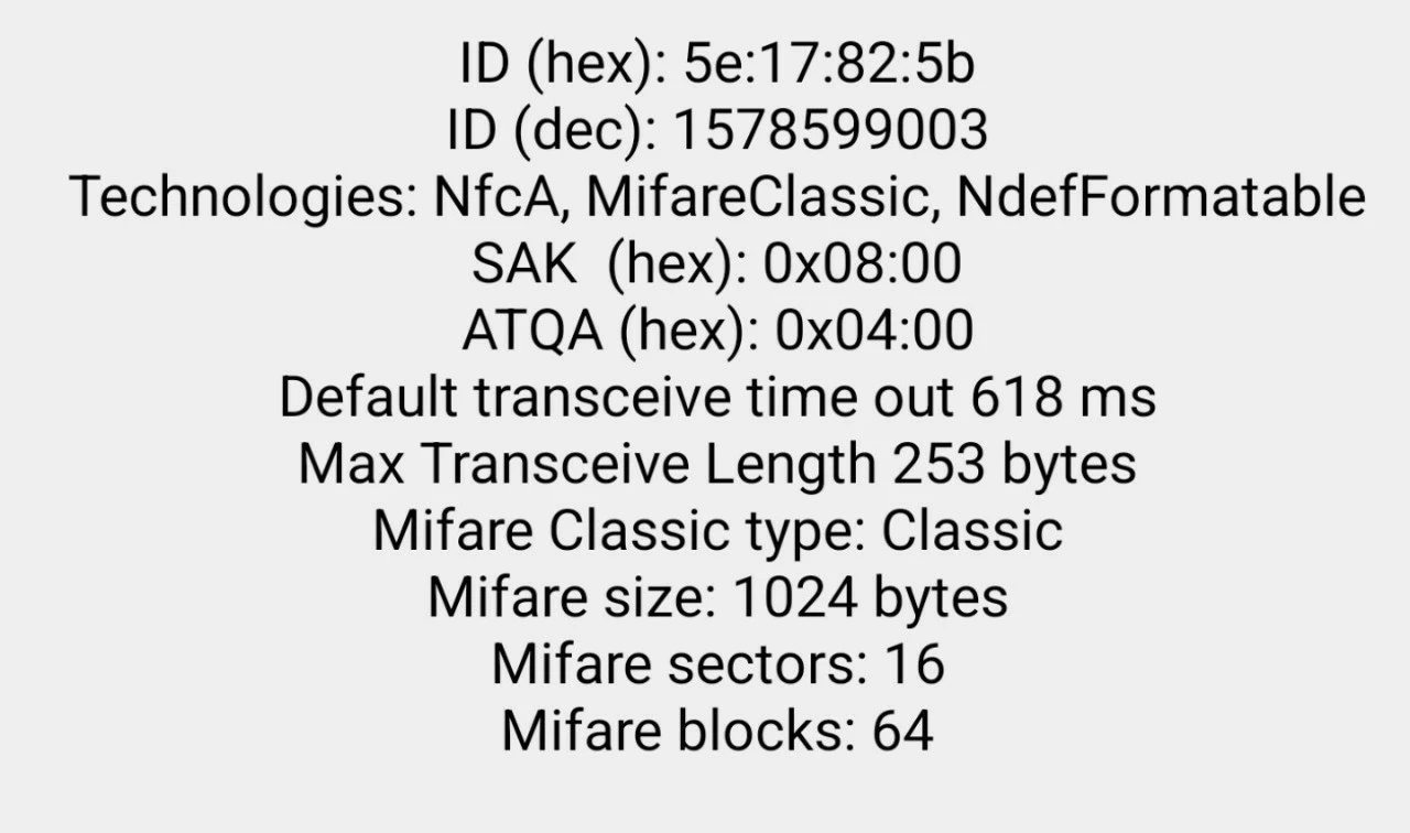

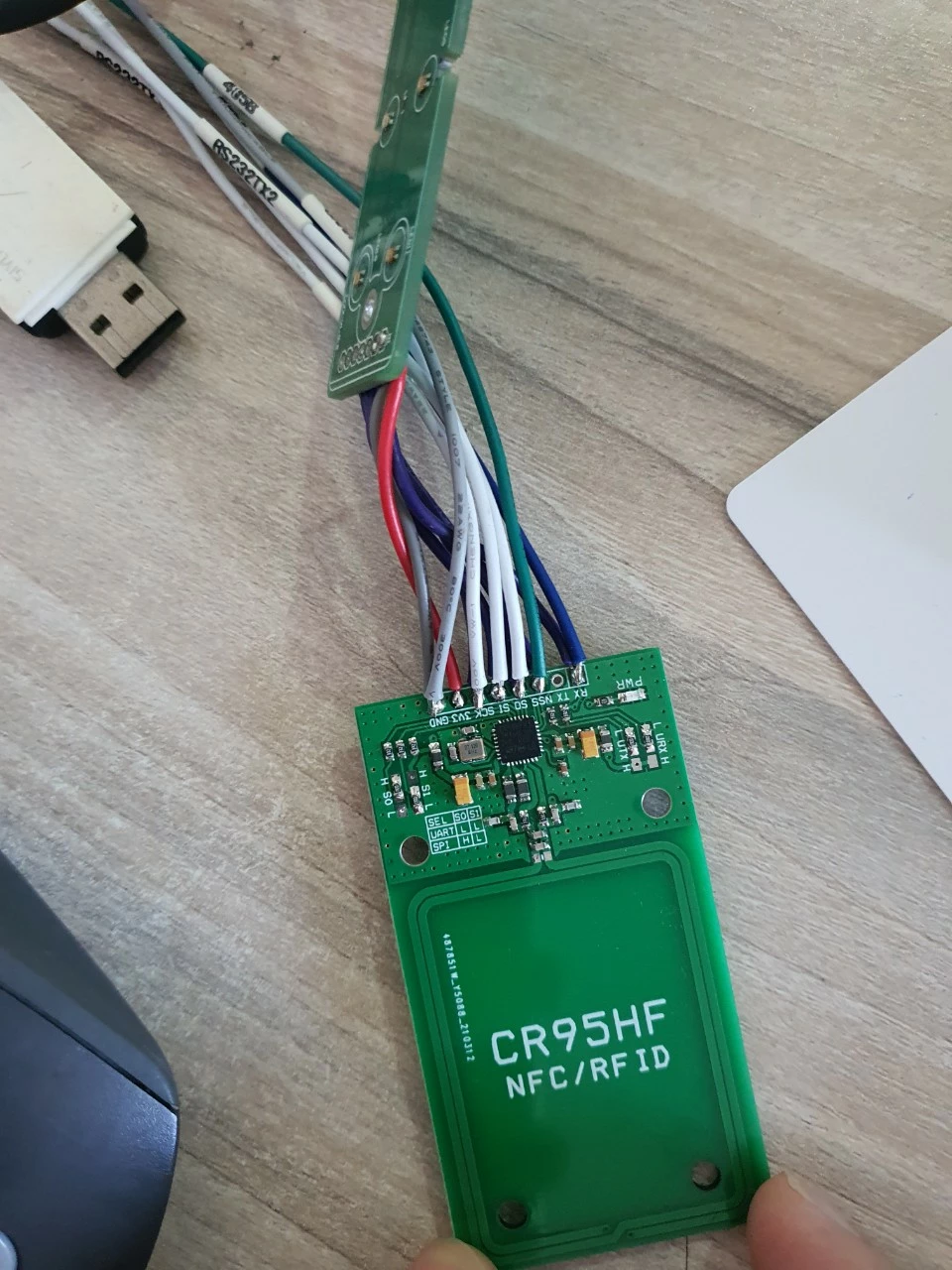

    I guess you are using a Mifare classic tag. For your information, reading block 0 after cascade level 1 anti-collision in such tags is only possible for UIDF1 personnalization. This was my rational for asking more information about the tag (model/manufacturer/personalization). Feel free also to share details about your hardware setup: do you use a custom board or a ST board (X-NUCLEO-NFC03A1 or M1054B transceiver board) or other ST board?

    0693W00000WI42FQAT.jpg0693W00000WI42KQAT.jpgyes, i have use mifare classic and this board connect to STM32F103C6T6
    because flash capacity of stm32f10c6t6 is small so i need more optimized library

    Ulysses HERNIOSUS
    November 11, 2022
    you seem not be aware of UIDF1. So likely the card is not personalized that way. Also reading block 1 will not work without cryptography and mutual authentication using crypto1.
    ST does not provide code for supporting MifareClassic cryptography.
    Please also see https://community.st.com/s/question/0D53W000014zGpESAU/st25r95-data-read-and-write-problem-iso1443a
    Best Regards, Ulysses
