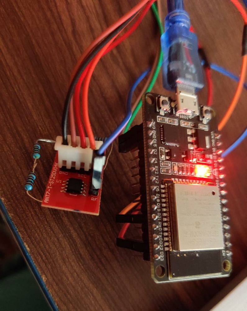

Im trying to interface ST25DV04K-8pin with ESP32Wroom. I have initialized I2C communication on ESP as Master.
Source files for ST25DV NFC - https://github.com/stm32duino/ST25DV/tree/master/src
NFCTagInitialise is failing as it is not reading the system Information at 0x17, 0x18-0x1f.
ESP - I2C driver returns error (-1). ESP is unable to write the target address to NFC chip (invalid address). Hence Read buffer is not loaded with the data from slave (NFC module)

Does the ST25DV is responding by an ACK to the Device address command on the I²C bus? (answer to this function ST25DV_IO_IsDeviceReady)
What can be checked is that you have a correct power supply for the ST25DV while trying to access the chip. If you are using the field to power up the ST25DV be careful to place the field on the antenna.
You can also check that you have correct pull-up resistors on the I²C bus (this depends on speed selected for the I²C bus).
Just for information the LPD pin is not available on the 8-pin package (this feature is only available on 12-pin package), but you can keep the LPD management in case you will need to use it.
Second point the 8-pin package is an open drain version for GPO, be careful to have a pull-up resistor on the GPO pin for a proper operation (not link to your current problem of course).
I hope this will help you.
Best Regards.
2021-05-21 2:40 PM
Thanks for the response.
ST25DV_IO_IsDeviceReady - This is failing with an i2c driver return value -1. I see that It is addressing 0xA6 where i2c is failing. Supply voltage is from the ESP32 development board 3.3V. I have added pull-up resistors of 10k to SDA and SCL lines for speed of 400000Hz.

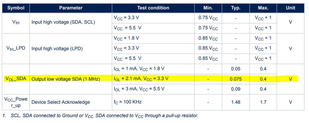

I saw the formulas to calculate - R(min), I calculate to get,
(Vcc-VoL) / IoL = (3.3 - 0.4)/2.1m = 1.3kOhm
I also tried with different pull up resistor values like, 1kOhm, 1.5kOhm, 2kOhm pull up resistors, but same i2c error.

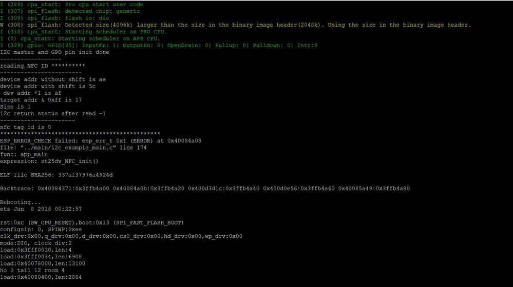

ST25DV source code ref : https://github.com/stm32duino/ST25DV/tree/master/src
My Program using ESP-IDF
#include "ST25DV_call.h" //Same as ST25DVSensor.cpp in the github reference
void app_main(void)
ESP_ERROR_CHECK(st25dv_NFC_init());
uint8_t *ret_uri=(uint8_t *)malloc(DATA_LENGTH); ;
readURI(ret_uri);
---------ST25DV_call.c file attached------------------------------
Device and target Address values printed. After reading we can see the I2C return value is -1
pin21 on ESP - SDA
pin22 on ESP - SCL
3.3V and gnd
pin 35 on ESP - GPO/RF
1kOhm in series to result 2kOhm pull up resistance.

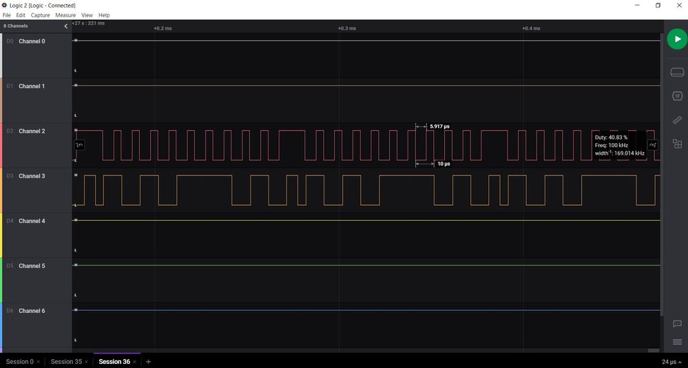

2021-05-26 4:15 AM
Hi Shruthi,
the recommendation is to look at SDA/SCL signals on ST25DV board: Use ideally an oscilloscope to look at the I2C traffic. Does it arrive at the board? And further on you can also see if ST25DV tries to acknowledge its address.
Regards, Ulysses
2021-06-05 6:31 AM
I did this and realized that there was no clock on SCL pin on ESP32 . I interfaced with STM-DK and works fine. Thanks for the support.

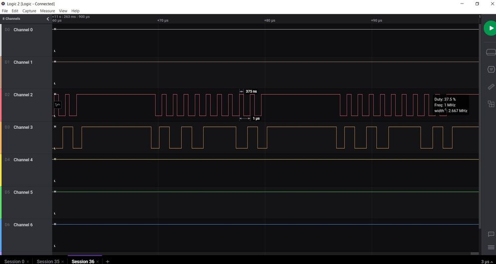

I tried with both 1Mhz(fast mode) and 100KHz . Both failed.
I also Read MB_mode and it was '0'. I tried to write '1' to this register which also failed and gave same i2c error
uint8_t* aTxBuffer[1] = {0x01};
while(HAL_I2C_Mem_Write(&hi2c1, (uint16_t)(0xae), (uint16_t)(0x000d), 2, (uint8_t *)aTxBuffer, 1, 1000)!= HAL_OK)
printf("Error in I2C IO Write\n");
Here are the clock images.
