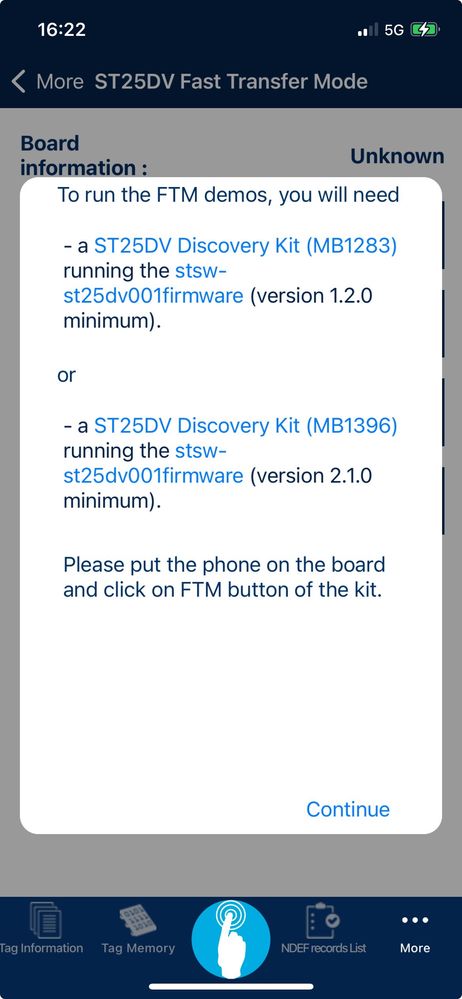

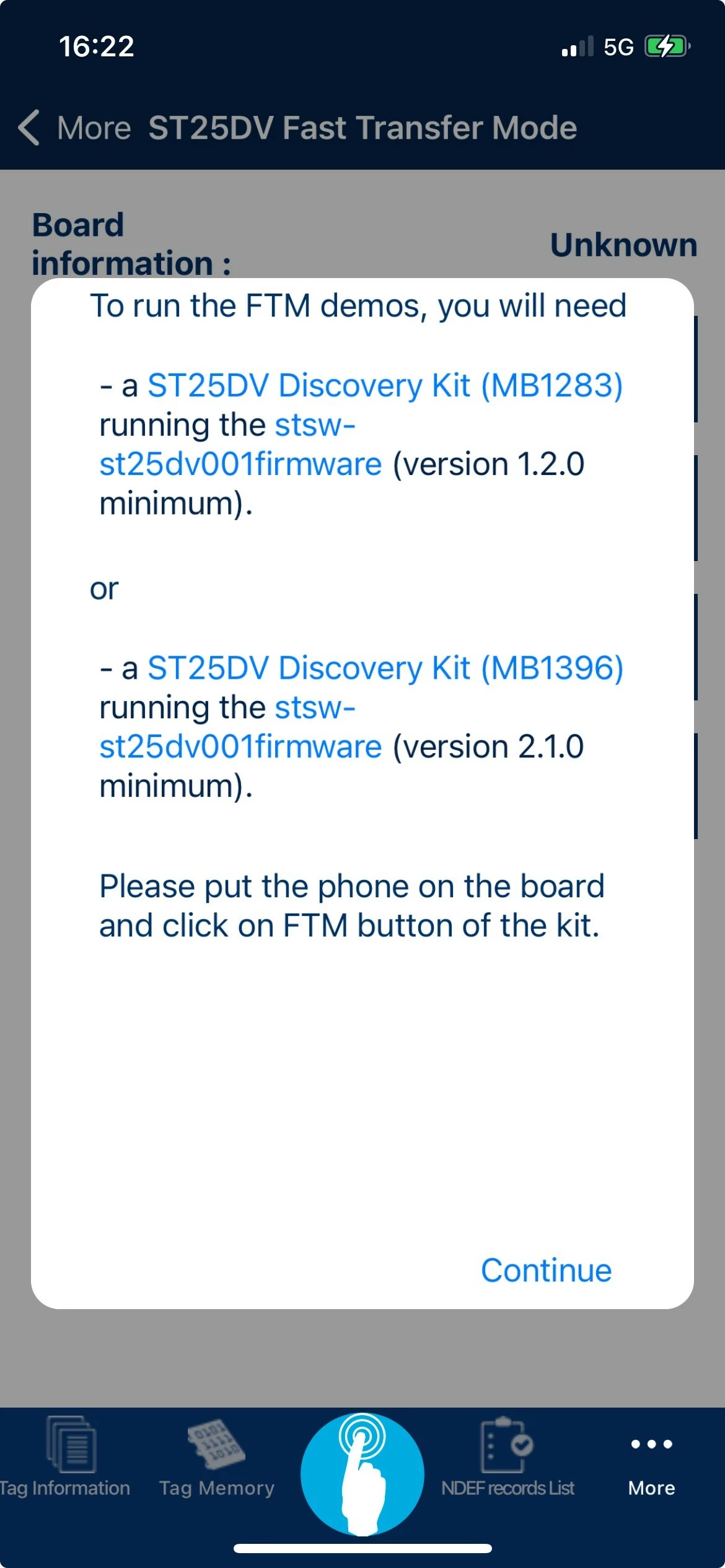

hi ,
Thx for your interest in iOS NFC Tap application.
I have made again some test today, and everything seems ok at my end.
I have tested on Discovery MB1396-B + FW 2.1.0, iOS NFC Tap from AppStopre V7.2 and from Source code on st.com as well.
Iphone used : iPhone12 pro
NFC Tag : ST25DV64KC.
Please, could you provide me more information on environment used, in order to be in same context as you?
- iOS NFC tap version (ref to "about" menu)
- iphone model + iOS version
- ST25 NFC Tag ? +,ST25 Disco board + FW version ?
Regarding "looping" when downloading the App from your Homepage, I have warned the team who is in charge of st.com. I saw same issue on Safari and MacOs.
Thx in advance for information.

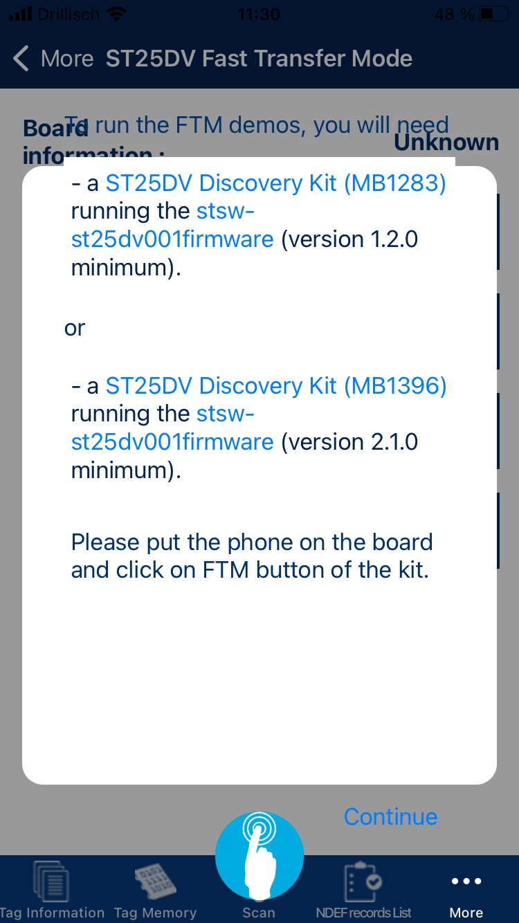

I am using the ANT7-T tag. And with this I am getting the strange behavior. I have as well the most recent version of the app. But the app in this menu is not usable after selecting FMT. It is not possible to click something.
CWies.1
CWies.1Author
April 9, 2024
As written before Iphone 8, iOS 16.7.7  but I guess it is something else with the strange web overlay which is shown in the screenshot.

You don't see the button "Continue" at the bottom of popup windows when selecting FTM mode ?
I guess there is a display issue with iphone8...
And you still have a crash ?

Button is not accessible and the FTM menu other menu is not reachable anymore.
victor laraison
victor laraisonBest answer
April 10, 2024
thx for you reply.
Ok, it is a UI issue. we're fixing it.
br,
