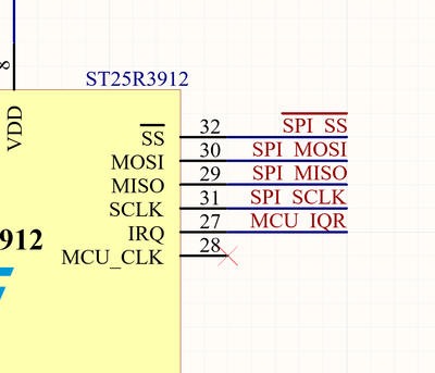

2023-10-17 12:54 AM
ST25R3912 has an MCU_CLK pin, but my product uses charger power only and I need to know about the Power level from the card.
1. Does This pin need to be used?
Best,
Dalik
2023-10-17 1:24 AM
The MCU_CLK pin may be use as clock source for the external MCU. The main use case is when using the transparent mode which is likely not your case (see https://community.st.com/t5/st25-nfc-rfid-tags-and-readers/mcu-clk-as-microcontroller-clock-source/td-p/232591 and other related posts. Se also the § Pin MCU_CLK in chapter 1.2.11 in ST25R3912 datasheet).
So I believe this pin is not needed in your application.
Rgds
BT
