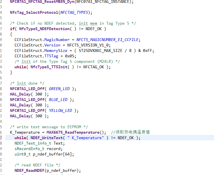

I want to read the sensor signal with NDEF_WriteText function,How do you read a temperature signal instead of a temperature text?
NDEF_WriteText funtion is printf funtion,so what should I do to read signal?

I am currently using ST25 to collect sensor information with NDEF, and I have written the code of temperature collection. For NDEF, how can I write the signal acquired by MCU into the label and read the real-time signal through NFC? What functions do we need?

I can understand what you mean, and I gave my relevant code on how to write temperature data to NDEF instead of temperature characters.

Rene Lenerve
Hi @帅 罗​,
Please use the code snippet button to insert your code :This button is available below the "Write an answer" frame. This will facilitate readers' understanding and discussion.
Now about your question, you get the information from the MAX6675 that you store in the variable K_Temperature (this variable is not defined in the sample code you provided, so let's assume it is defined as an int32).
You want to write it to the EEPROM of the ST25DV as an NDEF Text message using the NfcTag_WriteNDEF function. To do that you need first to convert it from int to char before.
But your code
uint8_t data[] = "K_Temperature";
will not do the job.
One possible way to convert could be the following code for example:

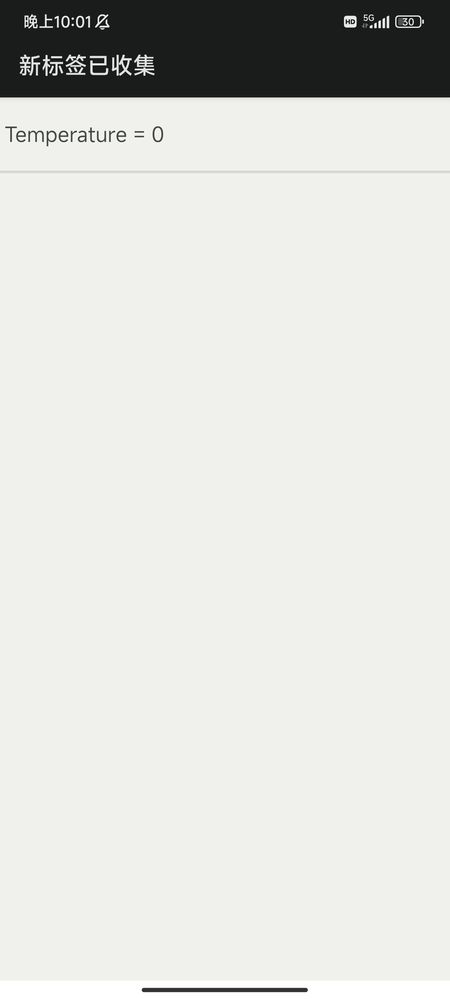

Schuyler
Senior
Hi,@Rene Lenerve​
I used the code as suggested by you,but my ST25 tap app only read temperature=0,please continue to help me to check the problem.

Rene Lenerve
Hi @帅罗.1 (Customer)​,
Please edit your message and use the code snippet button to insert your code (your message is not really readable)
0693W00000bjl27QAA_image.png:
You handled to write an NDEF Text message into the ST25DV, your issue is now around the MAX6675 by reading raw value and converting it into temperature. One thing to check is if your variable K_Temperature is correctly declared. I can't see it's definition in the extract of your code or maybe missed as message is not correctly formatted.
One precision, this forum is about ST products, so if you have any question on how to use the MAX6675, please consider to post on MAXIM's forum your question.
