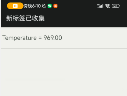

OK,I get the Temperature ,and I need real-time temperature data,so how can I make the temperature data change in real time.
Rene Lenerve
Hi @帅 罗​ ​,
This is an issue with the MAX6675, which is not an ST product. Please refer to the DataSheet of this component to see how to get the correct value, or ask on MAXIM for support on their product. And check also connection of the component to the board.
Kind Regards.

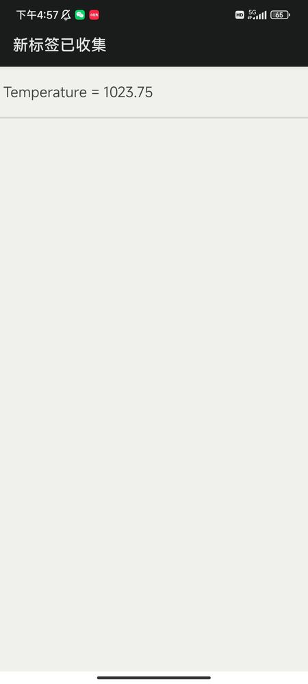

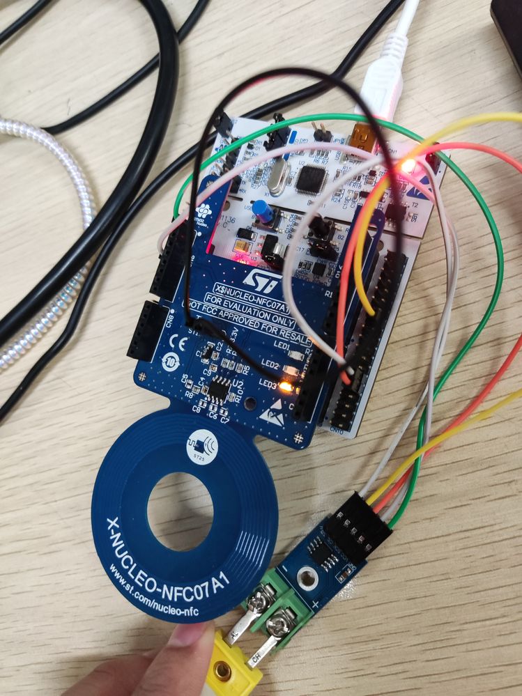

Hi,@Rene Lenerve​
I have checked my code and the data I read is 1023.75. According to the code, the output data is because the sensor is not detected, so I think there may be a hardware connection problem. Please help me check whether STM32L476 should be connected in this way?

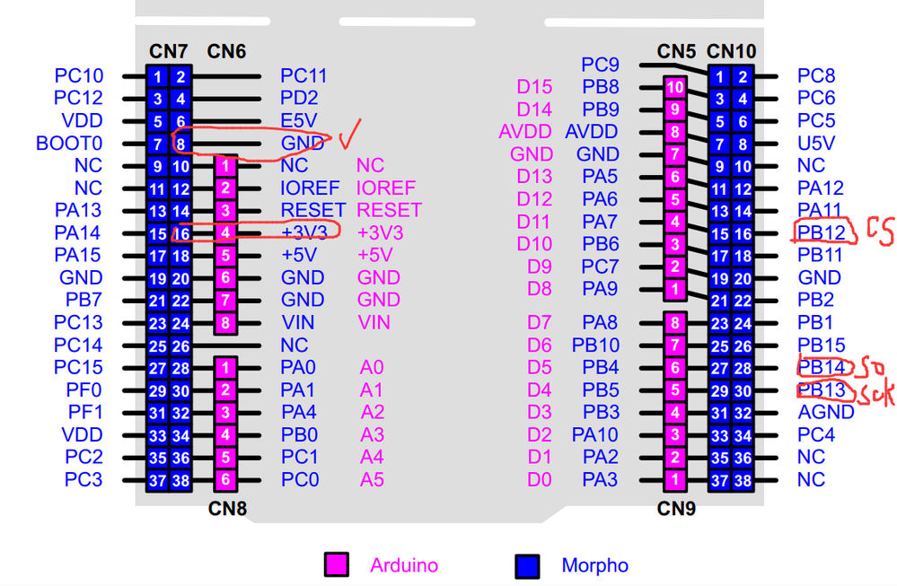

Rene Lenerve
Hi @帅 罗​,
Hardware connection seems to be ok.
You said that read data is 1023.75, so that means you can read data from the sensor. If this is the raw data this imply that the temperature read is around 256? (you should read this value in the NDEF Text record and not 0).
Only Miso is connected and needed to the sensor so you don't need to use the transmitreceive function.
You can change SPI configuration to this one (I don't have a MAX6675 sensor to test this code so consider it as example and adapt it if any error):

    /**SPI2 GPIO Configuration
    PB13     ------> SPI2_SCK
    PB14     ------> SPI2_MISO*/

The SPI speed of the sensor seems to be 4.3MHz max, have a look on your clock configuration and check that SPI_BAUDRATEPRESCALER_128 is ok to get the SPI speed needed.
Hope this will help you.

I changed my code as you instructed,but I still failed. Here are my codes,I think the temperature is not measured and the 12-digit data is 1, and the current data should be caused by incorrect reading of digits. Please help me to check it,I don't know why  I got 969.
static void MX_SPI2_Init(void)
