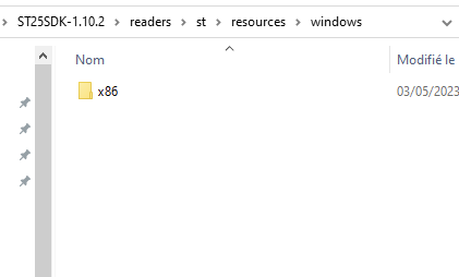

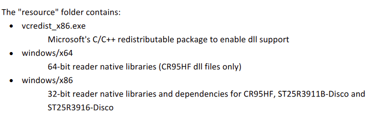

I'm trying to use the ST25 java SDK. The software_guide pdf document says I need to load in my IDE the natives libraries the SDK will need. It says I will find them in t \readers\st\resources, but in this folders there is only windows/x86 for the DLLs, and no windows/x64 as is mentionned in the document. And I can't use the 32bits version in my 64bits JVM. Am I missing something, or did the x64 folder was forgotten in the release ?
Extract from the pdf guide :
the readers/st/resources/windows folder from the sdk :

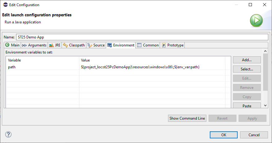

2023-05-12 2:26 AM - edited 2023-11-20 5:50 AM
in Eclipse we need to append the path to the resource folder to the path environment variable, such as shown in the picture below:
Make sure your path is updated in your run environment as well.
