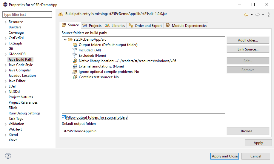

Make sure you indicate the path to the reader library in your application's Java Build Path as shown below:
As a reminder, the dll path should be indicated in the Source tab of the Java Build Path

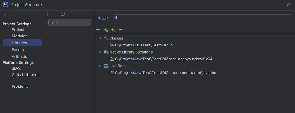

PBuro.1
I am using Intellij Idea, and not Eclipse, but I believe I set up both the dll folder and the jar folder right, but I still got that same error.

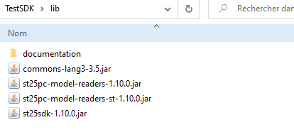

_legacyfs_online_stmicro_images_0693W00000bjqwBQAQ.pngThe lib folder contains :
_legacyfs_online_stmicro_images_0693W00000bjr6KQAQ.pngAnd the resources\windows\x64 contains the folder you sent earlier
