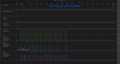

25MHz will not be possible with ST25R3916B. Please check the DS. Fortunately in your trace the SPI is rather at 1.6MHz.
Looking at the trace I find the IRQ pin staying high typically for ~6ms before getting cleared. The timeout handling is happening around <2ms but ISR seems to kick in only after 6ms.

to me it seems the ISR is not handled properly. The software is sending C8 command to turn on the field but ISR is not hitting and no read-out of Interrupt status registers (5A) happens. Then function st25r3916PerformCollisionAvoidance() returns an error and upper layer think field could not get turned on.
I propose to employ ST25R_SELFTEST and see to get basic platform functions operational.
BR, Ulysses

I have enabled the self test and it does fail. Attached the transactions and don't see the interrupt.

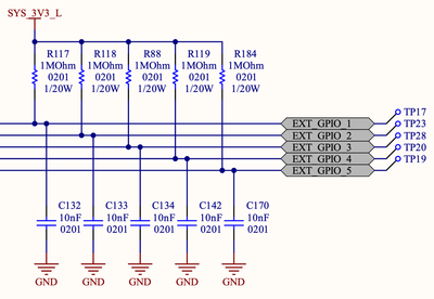

I have the GPIO interrupt initialized and enabled for positive edge properly and works if I simulate the GPIO pin. But don't see the interrupt from STEVAL-ST25R3916B reader expansion board.
We have the external pullup on this IRQ GPIO, I have it initialized as pulldown, but goes high as soon as it is connected to ST25R3916B and goes and stays low for the entire initialization.
Do you see any issue with this pullup? What should be the GPIO configuration for this IRQ?
having an external pull-up + internal pull-down is for sure not optimal. Also the digital Saleae traces will not show you the truth here. IRQ should only have a pull-down. ST25R3916B will drive it to VDD as long as interrupt condition persists.
Typically the IRQ pin is only for very short whiles (tens of us) high before the ISR kicks in, reads the interrupt status and thus clears the line again.
Having long high times on IRQ is an indication of issues - most likely in SW.
BR, Ulysses
