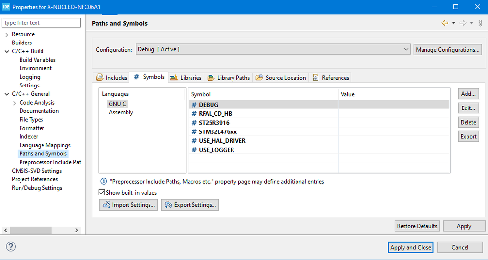

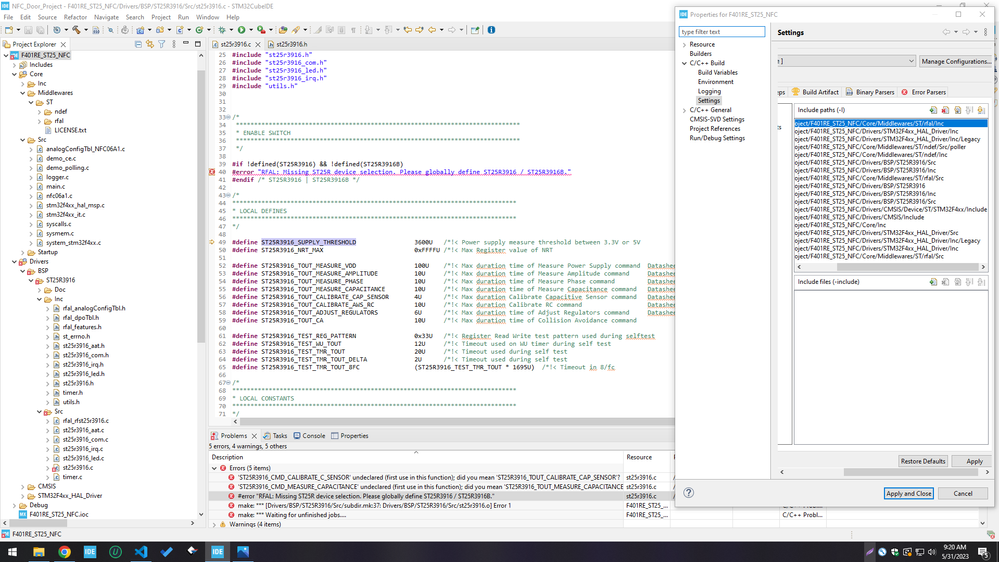

Pingstech
Hi Ulrich,
I've already tried exactly the same way but failed. I am attaching a screenshot of my project errors and path below.
Sincerely,
Ulysses HERNIOSUS
wells as the line tells you: You need to define ST25R3916 (when using NFC06) in the global properties. Likely something like:
Best Regards, Ulysses
