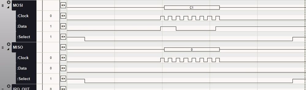

I don't really understand the datasheet of the ST25R3916 IC chip.
At page 53, they show an exemple of a direct write command. As I understand, we need to send 1-1-C5-C4-C3-C2-C1-C0. When I check table 13 to see the command code that go for bits C5..C0, the hexa is something like C1 = 11000001. There is 8 bits on the command code and on page 53 they only send 6 bits. I am confused...
Same thing to read a register for example. We need to send 0-1- the register address. There is no register that are 6 bits long, so how can I write my SPI package?

Regarding your initial question, the direct commands values in table 13 of the ST25R3916 datasheet include the heading 11b. This simplifies the reading of logic analyzer traces as we have the direct value of the byte being sent.
For example, here is the sending of Set default (C1h) command on SPI
0693W00000D0xD1QAJ.jpgRgds

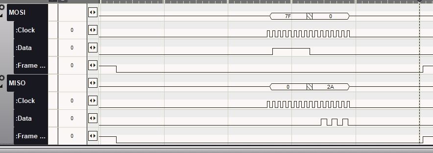

here is an example of reading the IC identity register (3Fh):

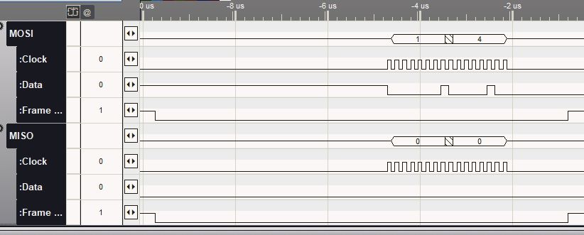

0693W00000D0zm0QAB.jpghere is an example of writing IO configuration register 2 (01b):

BT
