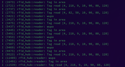

6 steps listed is what I do now in Rust library.
Issue is that if I have 2+ tags in field and I do WUPA -> select with anti collision -> get UID -> HLTA -> REQA -> select with anti collision -> no response ( Here I would expect to get next tag UID)
So it seems to me that HLTA put all tags in sleep state.

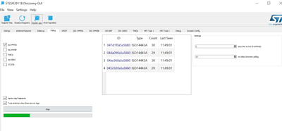

Actually if I replace wupa with field restart it solves my issue.
Here is capture where I keep field on. My tags are already on antenna from the start. First it reads both tags and then just one even after WUPA call
Capture
https://drive.google.com/file/d/1o9rzkzOWnQP6sZISLM1s_lf89QjXph5u/view?usp=sharing
