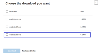

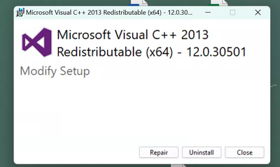

I installed Visual C++ Redistributable Packages for Visual Studio 2013 and that didn't resolve the crashing issue. Do you have any other solutions? Thanks in advance.
vcredist_x64.exe
as our application is x86's based, can you please try to install vcredist_86.exe.
Best regards,
NFC Customer Support
That worked! Thank you for your help take care.
