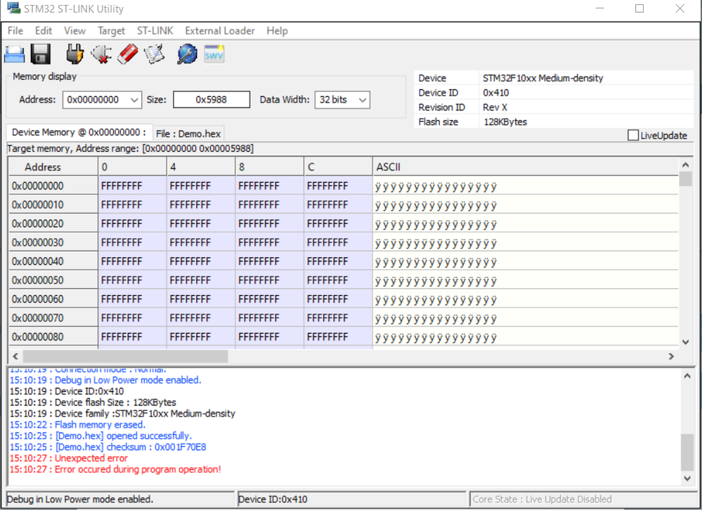

I am working on new M24LR discovery and trying to Flash default firmware of RF transceiver after erasing flash using STLINK/V2 utility.
I am able to erase the Flash but while I'm trying to Flash the .hex or Binary file, following error message displayed on Log window.
Unexpected error
Error occured during program operation!
below log is for your reference.
15:10:04 : ST-LINK SN : 50FF6D067788545417281567
15:10:04 : V2J34S7
15:10:04 : Connected via JTAG.
15:10:04 : JTAG Frequency = 140 KHz.
15:10:04 : Connection mode : Normal.
15:10:04 : Debug in Low Power mode enabled.
15:10:04 : Device ID:0x410
15:10:04 : Device flash Size : 128KBytes
15:10:04 : Device family :STM32F10xx Medium-density
15:10:15 : Flash memory erased.
15:10:19 : ST-LINK SN : 50FF6D067788545417281567
15:10:19 : V2J34S7
15:10:19 : Connected via JTAG.
15:10:19 : JTAG Frequency = 140 KHz.
15:10:19 : Connection mode : Normal.
15:10:19 : Debug in Low Power mode enabled.
15:10:19 : Device ID:0x410
15:10:19 : Device flash Size : 128KBytes
15:10:19 : Device family :STM32F10xx Medium-density
15:10:22 : Flash memory erased.
15:10:25 : [Demo.hex] opened successfully.
15:10:25 : [Demo.hex] checksum : 0x001F70E8
15:10:27 : Unexpected error
15:10:27 : Error occured during program operation!0693W000003QJXNQA4.png

Hi @ZMohd.7​ ,
I have tried with the version available on st.com, compiled the DEMO_BOARD_CR95HF project file and downloaded (.hex file) on the transceiver board with no issues. i configured St-link utility with same settings (JTAG 140 kHz, Normal mode).
Can you verify that you have the latest version of ST-Link Utility (4.5.0).
Can you also check that your ST-Link firmware is up to date (ST-Link > firmware update menu), mine is at V2.J34.S7.
Are you sure that the transceiver board is correctly powered through the USB cable. You can try another USB port. or a better case use a self-powered USB hub.
If you change the JTAG frequency to a higher value, does it changes the behaviour?
Hope this can help you.
