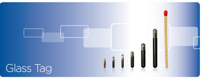

I use a glass tag from EM Microelectronic-Marin SA with a memory size of 208 bytes. At first I sent the IDN command to get the device ID, then I set the protocol to the ISO15693 by sending 0x00 0x02 0x02 0x01 0x0D. I don´t read or write on the tag yet, because I first wanted to test the function of getting the ID. Thank you for the library you showed me, I am going to look into that.

It is a type 5 tag.

is it this kind of product?

JudithAuthor
October 23, 2023
yes it is.

I do not have the exact physical dimensions of the antenna of this glass tag but it is likely very small. Thus the coupling with X-NUCLEO-NFC03A1 is probably quite low. A smaller antenna on the reader side would probably be needed to insure a good coupling to deliver enough energy to the tag and have reliable communication.
