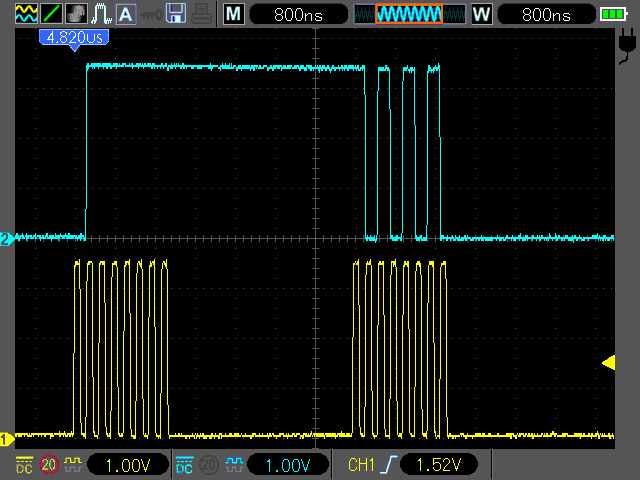

Hi Ulysses,
Nothing. I've created a STM32 project from zero using STM32CubeIDE v1.5 and the firmware packages v1.4 for the STM32G030K8 (my implemented mcu). Next I've started a Pinout + Clock Configuration with these parameters:
  • HCLK: 64MHz (APB peripheral clocks 64MHz)
  • SPI1_SCK: PB3
  • SPI1_MOSI: PA12
  • SPI1_MISO: PA11
  • CS (GPIO): PB0
  • IRQ: GPIO_EXTI4
SPI configuration (for running at 4Mbps)
  hspi1.Instance = SPI1;
  hspi1.Init.Mode = SPI_MODE_MASTER;
  hspi1.Init.Direction = SPI_DIRECTION_2LINES;
  hspi1.Init.DataSize = SPI_DATASIZE_8BIT;
  hspi1.Init.CLKPolarity = SPI_POLARITY_LOW;
  hspi1.Init.CLKPhase = SPI_PHASE_2EDGE;
  hspi1.Init.NSS = SPI_NSS_SOFT;
  hspi1.Init.BaudRatePrescaler = SPI_BAUDRATEPRESCALER_16;
  hspi1.Init.FirstBit = SPI_FIRSTBIT_MSB;
  hspi1.Init.TIMode = SPI_TIMODE_DISABLE;
  hspi1.Init.CRCCalculation = SPI_CRCCALCULATION_DISABLE;
  hspi1.Init.CRCPolynomial = 7;
  hspi1.Init.CRCLength = SPI_CRC_LENGTH_DATASIZE;
  hspi1.Init.NSSPMode = SPI_NSS_PULSE_DISABLE;
  if (HAL_SPI_Init(&hspi1) != HAL_OK)
    Error_Handler();
the test code is very straightforward
HAL_Init();
SystemClock_Config();
MX_GPIO_Init();
MX_SPI1_Init();
tx[0] = 0x7F;	// ST253916 read ID
tx[1] = 0xAA;	// dummy byte
HAL_GPIO_WritePin(GPIOB, GPIO_PIN_0, 0);                         // Chip Select (Low)
status = HAL_SPI_TransmitReceive(&hspi1, tx, rx, 2, 1000);       // send & receive
HAL_GPIO_WritePin(GPIOB, GPIO_PIN_0, 1);                         // Chip Select (High)

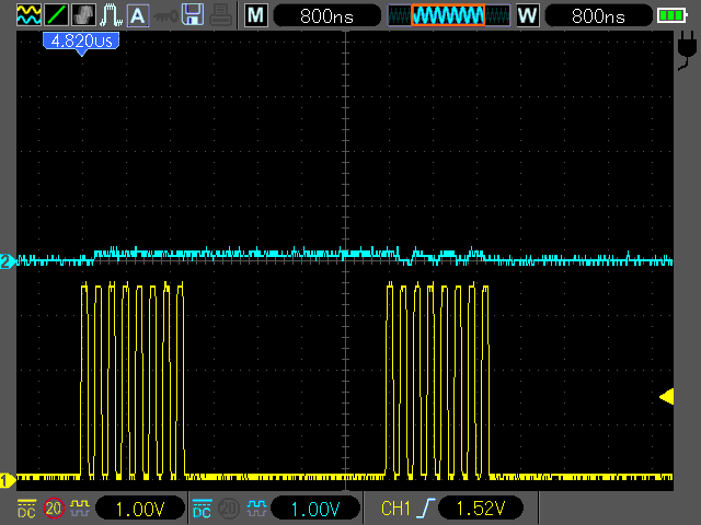

At the end the MISO line is stuck at GND (I was wrong in my previous post).
Here's the captured waveform
for the MOSI line
and for the MISO line
What else can I try?
regards,
gaston

Gaston
Senior
Hi Ulysses,
Looks like it was an issue related to some (bad ) soldered decoupling capacitor. I have reworked a few points and now I can see the 0x2A data on the MISO line.
Again, thanks for your help,
regards,
Gaston
