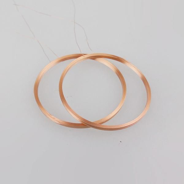

vaibh_p
Hi Henry ,
Any design reference or guide for Inductance calculation of CIRCULAR [All turns are of same diameter] Coil Antenna ?
I have tried on several websites , but most of them offer for Solenoid , which have one parameter of length , I tried with some negligible length value , but we didn't get the expected range .
Henry Crane
sorry to answer to you with a question but I am not your to understand your need. do you plan to design a multilayer circular antenna similar to a solenoid, or a planar (spiral) coil?
Best Regards,
HC
vaibh_p
Hello Henry ,
We want to design antenna as shown in figure.
So we need reference for calculating the inductance of such antennas.
I guess this is one called as "Multilayer Circular Antenna" ?0693W000003QXxAQAW.jpg
