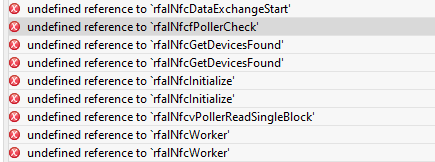

I followed your instructions to port one of the basic examples to the F446RE.
It works up to the point, that some "undefined reference to" errors occur.
I already checked the forum to solve the problem, but without success.
It seems to be a linker problem...but to which library path i have to link?

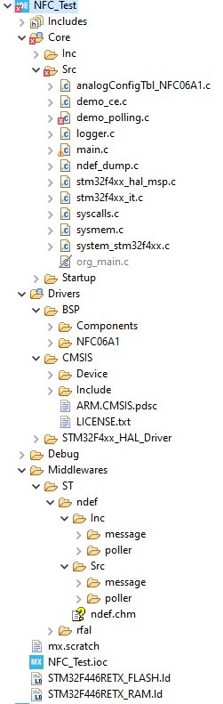

The project structure is
Do you have any further information which helps to get the system running?

Hi Sebastian,
the mentioned functions are defined in rfal_nfc.c. Should be under the last directory of the shown "Middlewares".
BR, Ulysses

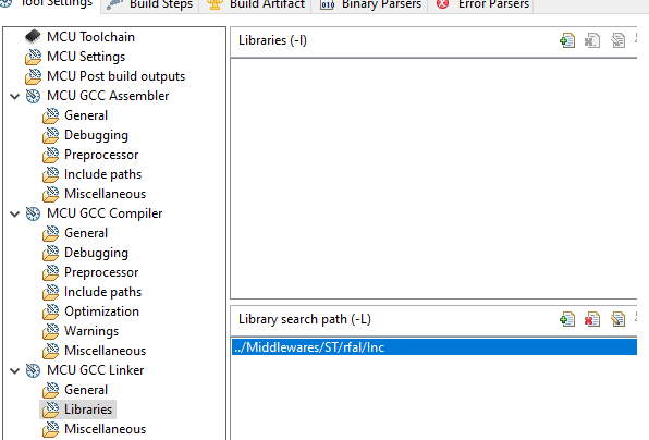

I already found the references in the rfal_nfc.c, I can use the ctrl-shortcut to go (from demo_polling.c to rfal_nfc.c) to the reference of the corresponding function. Hence, it seems to be a problem with the linker.
So my question: Which Library / Library-Path has to be add in the linker option?
0693W00000GZenvQAD.pngThis doesn't work.
BR, Sebastian
Brian TIDAL
Hi Sebastian,
there is no specific linker option or lib/libpathc/etc.. Make sure rfal_nfc.c is compiled and that rfal_nfc.o is in the list of objects being linked by the linker.
