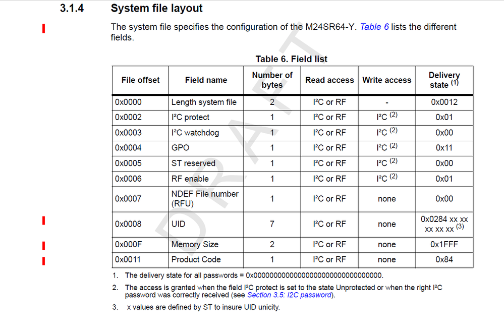

After verification, GPO mode is only configurable by I2C and not by RF.
By RF, you can only read GPO mode and GPO value, and that"s all.

victor laraison
ref to table6 of M24SR datasheet

Actually, the issue is not about configure the GPO mode with RF. We are aware that GPO mode is only configurable by I2C. In fact, we set up the GPO to "State Control" (p.19 in the datasheet) with I2C before starting to interact with it through RF.
This mode allow us to drive GPO pin by sending a "valid Set GPO command" (quote from the datasheet). As mention Adura in his first post, we are able to do it on Android, by using the activePinGPO found on your android library.
