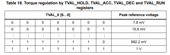

Hello everybody, I have a question I can't solve. I use the X-NUCLEO-IHM03A1. My question is : wath is the link between the TVAL values in the register of the Powerstep01 (see figure) and the voltage accross the shunt resistor of the board (100 m ohms). 0693W00000APL7SQAX.pngAs you can see, the value register set the peak reference voltage for the currrent mode regulation. But, if i take for example 117 mV as peak reference voltage for the holding torque, and if i measure the voltage accross the shunt resistor, it is way below this value (it is 3,6 mV) so i don't understand the link between these two value ...
Thank a lot for your Help !

I confirm that the TVAL_X value set the peak reference voltage for the current control algorithm.
The integrated comparator compares the shunt resistor voltage with the internal reference generated using the peak value, which is proportional to the output current amplitude, and the microstepping code.
To better understand what happens in your application could you share:
  • the powerSTEP01 registers configuration
  • a scope waveform of shunt voltage
For more details on powerSTEP01 peak current control you can refer to the application notes AN4158.
