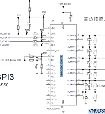

Dear sir:
I was used VN9D30Q100FTR 6-channel high-side driver for automotive electronic products,the schematic diagram below:
According to the datasheet, the PWM clock should be provided via the PWM_CLK input, but there was also this note about the PWM fallback clock:
"When PWMCLOCKLOW warning flag is set, an internal fallback clock (at a typical frequency of 400 kHz) is used
to substitute the external one."
My question was :Can there be PWM signal output for controlling the high side?
