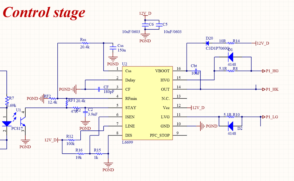

I encounter a problem about L6699.
I'm testing in open circuit, so thePC817 is open and all other parameters as shown in the figure.
1.The delay is disabled.
2.STBY(I'm wrong with stay) is equivalent to short with RFmin.
3.ISEN is biased with 0.6V.
4.LINE is pull-up to VCC with 100 kohm.
5.DIS is disabled as well.
the Fmin set to be 150 kHz and Fstart is set to be 230~240 kHz.
Board test result with every pin voltage is below:
1.CSS      2V
2.DELAY  0V
3.CF         0V
4.RFmin   2V
5.STBY    2V
6.ISEN     0.7V
7.LINE      6.1V
8.DIS        0V
It seems that the L6699 can work, but the timing capacitor doesn't charge and discharge.
I replace L6699 with L6599A is work.
Are my parameters wrong? or there is something with fatal problem?
