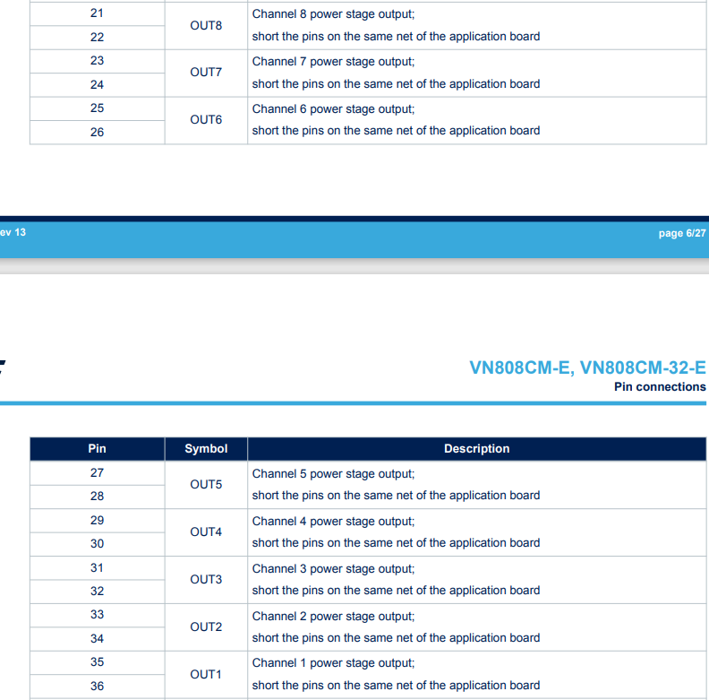

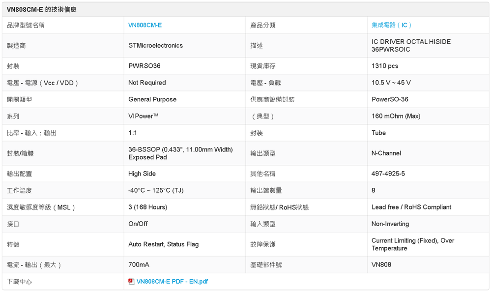

您好,實驗室有用到您們生產的VN808CM_E產品,關於產品規格表的電流-峰值輸出有疑問(圖一) 0.7A是指八個通道總共的最大電流嗎然後我看這個產品每個通道的output一共有兩個是互相連接的(圖二),這樣會導致輸出的電流變更小嗎?
(700mA / 8 / 2= 43..mA (每一個output的電流)) ,如果我打算在output連接端用電流去驅動的話,把同一個channel裡面兩個內部連接的output在外部利用PCB走線,再度連接成真正一個輸出端口的話,可以有助於電流的提升嗎?( 700mA / 8 = 87.5mA)

Welcome @Leon_show, to the community!
You have probably misunderstood the data sheet of the VN808CM-E:
  • each of the 8 outputs can drive 0.7A - i.e. a total of 5.6A when all outputs are switched on
  • each of the 8 outputs has two pins which must be connected to each other on the board if you want to drive the full current, i.e.:
    • OUT1 = pin 35 and 36 together
    • OUT2 = pin 33 and 34 together
    • OUT3 = pin 31 and 32 etc
Hope that answers your question?

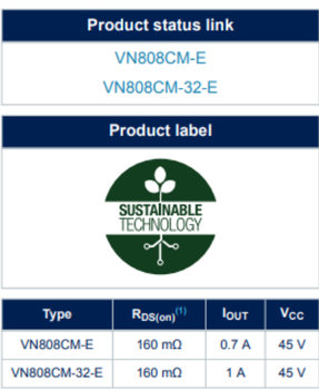

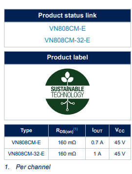

hello,

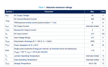

Thanks for your reply before !  i still have another question about VN808CM-E:
I want to deduce the voltage or current output conditions of a single channel of the IC in HIGH LOGIC through the specifications provided in the DATA SHEET. However, in Figure 1 of the datasheet, it only mentions that Iout is internally limited. Yet, in Figure 2, there is information indicating VCC: 45V, Iout: 1A.  And then i hope i can know the output current's value in each  VCC when the logic is high.  can you provide more detailed information for me to figure out my request.?
Peter BENSCH
The information on page 1 of the data sheet is intended to provide an overview of the device and the load range in which it can typically be used. Table 1 then shows the maximum permissible parameters, whereby the DC output current is correctly listed as Internally limited, as an internal protective circuit prevents the VN808CM-E from being exceeded and thus overloaded.
I don't understand your last question about the current. Can you please describe in more detail what you mean?

hello,  Peter BENSCH      professor
Certainly, I will provide a more detailed explanation below. Through the diagram below, we can ascertain that for a single channel of VN808CM-E, when VCC is 45V, the Iout is 1A. I would like to inquire, if I control VCC within the range of 10.5V  to  32.5V , will Iout vary with VCC, or will it remain at 1A?
Thank you for your sincere response!
Firstly, a request: I am not a professor, just a member of staff at ST who wants to help you and others. It is sufficient to address me by name.
About the VN808CM-E:
  • the maximum current is not voltage-dependent, so the current is limited in the same way with a smaller VCC
  • only the VN808CM-32-E can switch an output current of min. 1A, the VN808CM-E is designed for typical loads of min. 0.7A. Even if a max DC short circuit current of 1.7A is specified in table 6 of the data sheet, this is only the upper limit of the current limitation, which varies depending on the specific example and temperature.
It would therefore be very wise to only use the minimum value of the current for your design so that you do not experience any unpleasant surprises. So if your loads draw up to 1A, you should use the VN808CM-32-E instead of the VN808CM-E.
