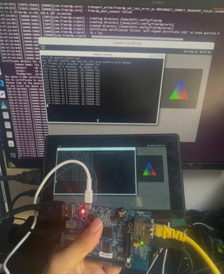

After successfully RDP to my board
Now i want to make fake HDMI information, to make it auto output. So i no need to plug in HDMI display, but still can connect through freeRDP from PC.
Can someone here ever did this, or have any ideas about how to do it under yocto build.

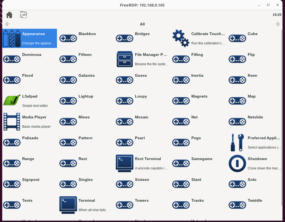

After trying some more time. I switch from Weston RDP to X11 RDP, now i got it run in first-time
Here what i modify to make it work
In local.conf i need to add
INIT_MANAGER = "systemd"
I build core-image-sato because it has X11 natively
I create core-image-sato.bbappend
inherit extrausers
PASSWD = "\$5\$y9Aeg5ctwntRHo/g\$CAKtoTfQg7VPGfVAMGo5ZG/0GJLn3AD0JdoQ.i0dDFC"
EXTRA_USERS_PARAMS = "\
    usermod -p '${PASSWD}' root; \
IMAGE_FEATURES:remove = "ssh-server-dropbear"
IMAGE_FEATURES:append = " ssh-server-openssh"
PACKAGE_EXCLUDE += "linux-firmware-addons-bcm43xx"
IMAGE_INSTALL:append = " \
    python3-jinja2 \
    dhcpcd \
    iproute2 \
    iputils \
IMAGE_INSTALL:append = " xrdp xorgxrdp "
After flash you need to create key for xrdp
mkdir -p /etc/xrdp
xrdp-keygen xrdp /etc/xrdp/rsakeys.ini
printf 'XRDP_OPTIONS=\n'       > /etc/default/xrdp
printf 'SESMAN_OPTIONS=\n'     > /etc/default/xrdp-sesman
systemctl daemon-reload
systemctl restart xrdp
systemctl restart xrdp-sesman
Also create session file
cat > ~/.xsession <<'EOF'
#!/bin/sh
exec /usr/bin/sato-session
EOF
chmod +x ~/.xsession
Remember to make enable ssh from board, need to modify /etc/ssh/ssh_config change these field
#PermitRootLogin prohibit-password  --> PermitRootLogin yes
#PasswordAuthentication yes  --> uncomment PasswordAuthentication yes
After that remember to restart sshd.socket
systemctl restart sshd.socket
Now from PC connect through RDP using xfreerdp
xfreerdp /v:<ip of board> /u:<user> /p:<password> /dynamic-resolution /cert:ignore
