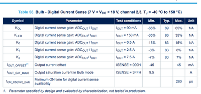

I am currently working with the VN9D5D20FN and RL78, successfully controlling 4 channels at a 100% duty cycle, achieving a 12V output. Now trying to read the current sense value for Channel 1 with OUTCFGR1 configured to 0x9FE0 and a rheostat load applied. I've readed the ADC values from the ADC1SR register and measured current consumption with a clamp meter.
Could you please assist me with the following:
  1. How should I calculate the current value from the ADC1SR?
  2. What is the K value in the Iout_conv formula for each channel?

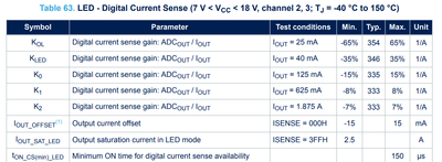

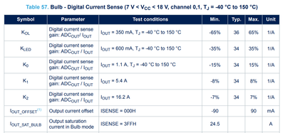

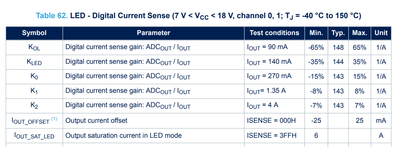

The K values are listed separately in the data sheet for the various functions in tables 57, 58, 62 and 63.
The topic of K values is also discussed in detail in AN5792. In section 2 you will find a consideration according to which your measured current of 1...2A is within a fairly large tolerance range for K.

in DS:
