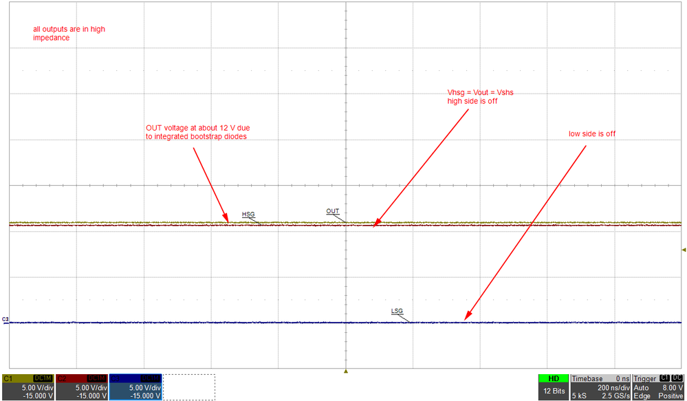

Hi @ARaj.1​,
I double checked on my side using the attached project.
All the power stage outputs are in high impedance:
0693W00000Dq3lkQAB.pngIn this condition the power stage output is weakly pull-upped at 12 V by the bootstrap circuitry as expected.

Hi Enrico, sorry for the late reply. I am trying to understand the diagram you attached. So it looks like the high side gate voltage is HIGH-Impedance not HIGH (i.e. in the middle between low and high?). The low side gate voltage is LOW on your plot.

Hi @ARaj.1​
In my screenshot high side output is actually LOW because it is referred to OUT pin:
  • HS LOW --> GHS - OUT = 0
  • HS HIGH --> GHS - OUT = VBOOT
About your questions:
  • if input voltage is 10V, a high voltage will be 10V, high impedance will be 5V and low voltage will be 0 V?
ANS: I guess it will be probably 10 V. I guess the high impedance value will be probably 10 V.
When the output is in high impedance, it's voltage is easily biased by any leakage. In normal conditions the main leakage comes from the integrated bootstrap diode and rise the output voltage up to VREG12. If supply is 10 V, I expect VREG12 = 10 V --> VOUT = 10 V.
  • If the above is the case what is the reason for this. Why can't both high-side and low-side gates have gate voltages of 0V, why does the output have to be in high-impedance mode when both GPIO's are low
ANS: High side gate driver output must be always referred to the OUT. This because the main objective of the circuit is apply the proper Vgs voltage on the high side MOSFET , where the source is in fact the OUT of the power stage.
Referring the high side gate driver to the ground could cause gate-source breakdown of the MOSFET-
  • As I understand it high-impedance mode is used for communication bus so that it's in a undetermined logic state. However here we are driving motors, so what is the purpose of the high-impedance mode here?
ANS: In motor driving high impedance has the main purpose to impose no current into the windings.
