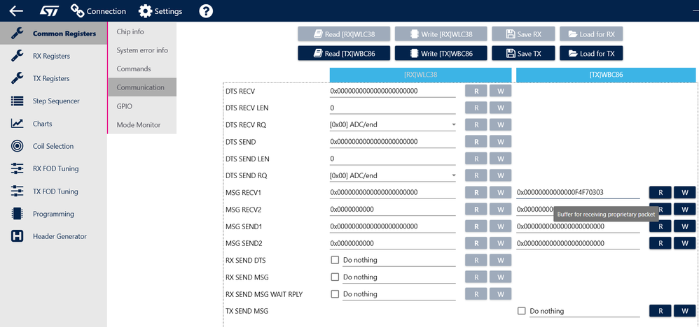

I am using a STEVAL-WBC86TX Wireless Qi transmitter. I am going through a code and couldn't figure it out what is the meaning of the code(proprietary packet) received by the transmitter. Can any one help me to understand the meaning of this code.

The packet you are showing (03 03 F7 F4) is not a proprietary packet, but a standard Qi packet.
In this case, it is a Control Error Packet sent by the receiver to regulate the level of transmitted power.
The Control Error Value (F4) is a two’s complement signed integer value that is a relative measure for the deviation
between the actual and target operating points of the Power Receiver. It is usually updated every 250ms.
