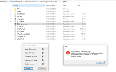

I have bought an STEVAL-PCC009V2 interface board that I want to use to drive an EVAL6472 stepper motor driver evaluation board but when I connect it to my Laptop Running Windows 10, it prompts me to update the firmware to the latest version 2.7 Firmware.
I have tried updating the firmware through the IBUUI Updater application but get the following message:
I have checked with our IT department and it doesn't seem to be blocked by our network, because I also tried running it as Administrator and got the same result.

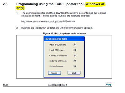

After further investigation I came across a note that indicates it is only for Windows XP:
My questions are as follows:
1. Can I update the Firmware on the STEVAL-PCC009V2 Interface Board by programming the V2.7 hex files directly onto the board with a compatible ST Micro programmer?
2. Will the STEVAL-PCC009V2 function correctly on my Windows 10 machine after the upgrade to the latest Firmware (fwpsin_pcc009v2_FWV2_7.hex), or does it only work with Windows XP and Windows 7, regardless of the Firmware version?
