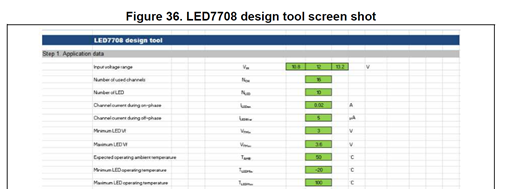

2.    Additionally I would like to have the spreadsheet for “LED7708 design tool�? that is referenced and described in your application note AN4578 in paragraph 4 “Step by step design�? on page 32:

2)    Mentioned LED7708_design_tool.xlsx is also included in attached ZIP file.
