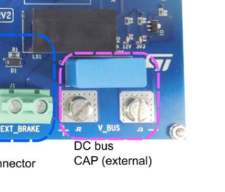

STEVAL-HKI001V2- How to connect 36V to 330V DC power supply on 3 phase AC supply
ESK
Please provide and diagram or application note on the same.
8 REPLIES 8
Gigi
Ciao
I never tested it but, I think, that if you want to supply a DC voltage to the board is possible to use the same connectors where you mount the external DC Capacitors respecting the polarity.
See UM2645 for some details on the board.
Ciao
Gigi
