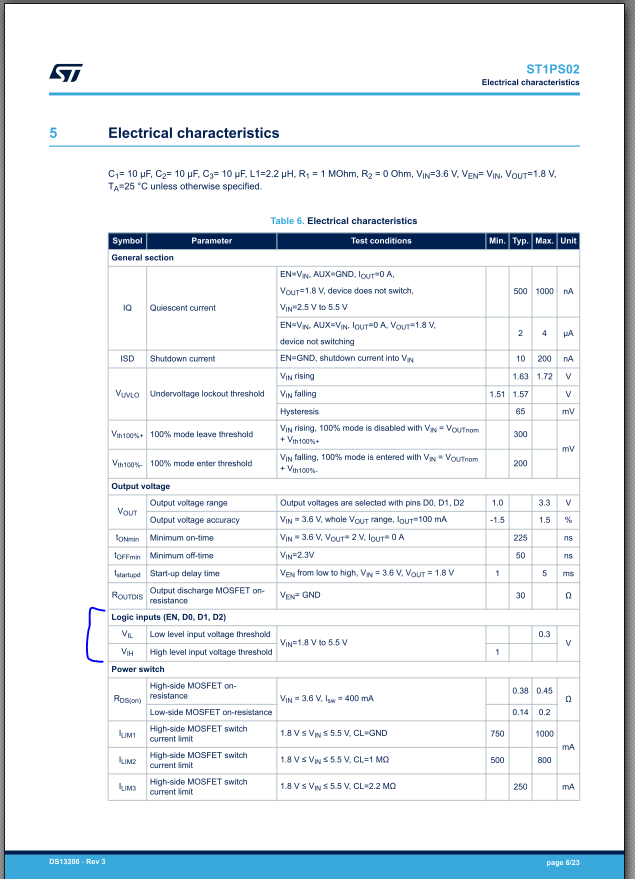

ST1PS02BQTR Logic Inputs Leakage Current
CMehr.1
0693W000008w3xxQAA.pngCan anyone say what the leakage currents on the ST1PS02BQTR logic inputs are? Usefully I can see the voltage levels, but leakage current into the pins is not specified from what I can tell.
