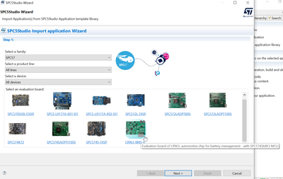

I'm trying to communicate with L9963E using SPI mode. MCU is 16bit dsPIC microcontroller. Can someone share some sample C programs related to Initialization and single access read of L9963 registers?
1 REPLY 1
KTANG.9
Sample software is in SPC5 Studio - import projects -> SPC57 ->L9963_BMS_IC
https://www.st.com/en/development-tools/spc5-studio.html
