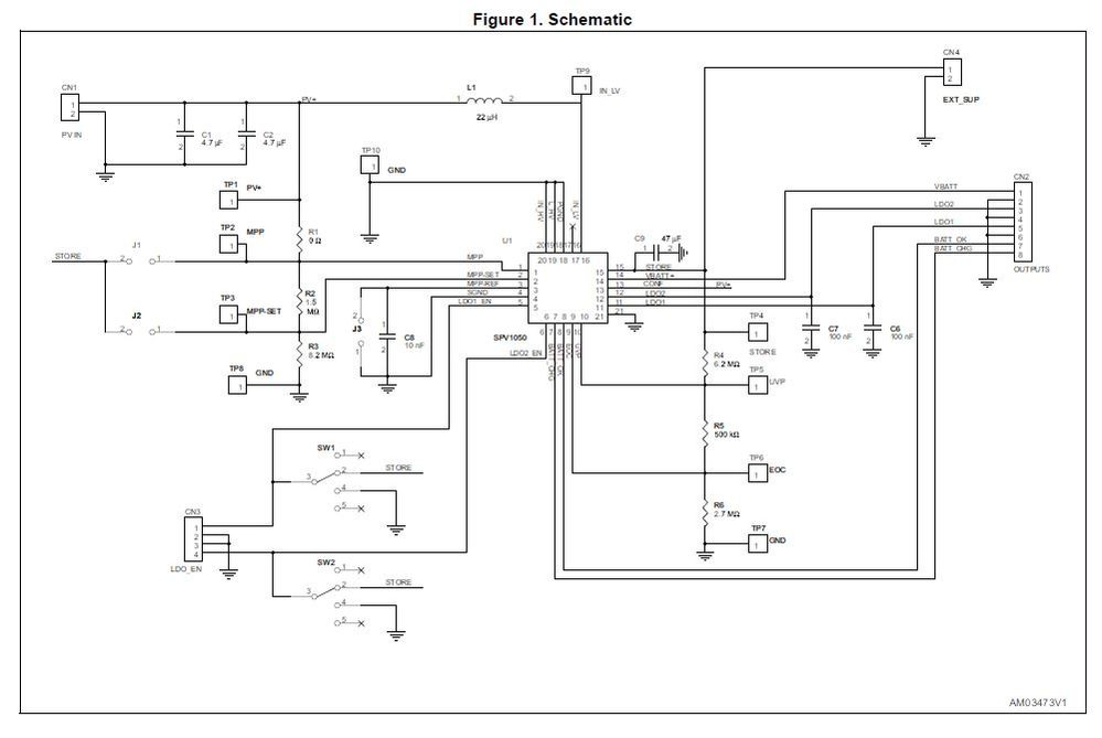

On the datasheet itself, it is mentioned in the application section that it can be used to charge a supercapacitor. So why it is so questionable to be used with supercapacitors? I want to use the MPPT at every cost. Please suggest me accordingly. I have an evaluation kit (Development board) with me. Here the values of these resistances are fixed I think, so how I will set them? Please tell me the connection procedure for this particular board. I'm unable to operate this board. Please let me know the connection procedure or provide me training video/ operation manual or any such material to operate this particular board.
Prajnyajit
Prajnyajit
  1. For safe operation, VEOC should be 3V (not 3.2 V) and the Vupv should be 2.2 V. How to set this thing on the development board STEVAL-ISV019V1?
  2. In this condition and with the solar cell specification it will operate in buck-boost mode. I agree with this. But how to select this mode on STEVAL-ISV019V1 or it will be auto-selected?
  3. Tell me how can I set MPPT on STEVAL-ISV019V1?
  4. In my case I think my supercapacitor will be connected to CN2 pin 1 and Pin 2, isn't it?
  5. PV will be connected to CN1, Pin1 & Pin2, isn't it?
As long as I use STEVAL-ISV019V1, this configuration is enough for my application or not? Please advise me of any further connection-related thing, if I have missed any which is necessary for it.
For simplification and better understanding, I am attaching the circuit diagram and you can mark the connection diagram in the picture itself.
Peter BENSCH
The STEVAL-ISV019V1 cannot be used for your application due to fixed connections for boost operation:
  • IN_LV (16) connected to the input voltage
  • IN_HV (20) is connected to GND
You should use the STEVAL-ISV020V1 (Buck-Boost) instead.
