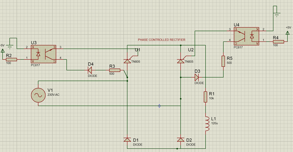

How to Control the SCR with Microcontroller. I dont want to mix the Digital Signal Ground with the High Voltage Ground. But the SCR will need the Gate current in uA w.r.t its Cathode. But I couldnot connect the Cathode of SCR to the control circuit..
Help me a correct Triggering Circuit for SCR on the Bridge Rectifier.

Hello
A recent Application Note answers you.
AN4606 : Inrush-current limiter circuits (ICL) with Triacs and Thyristors (SCR) and controlled bridge design tips
=> See section 2. Control circuits.
Best Regards
