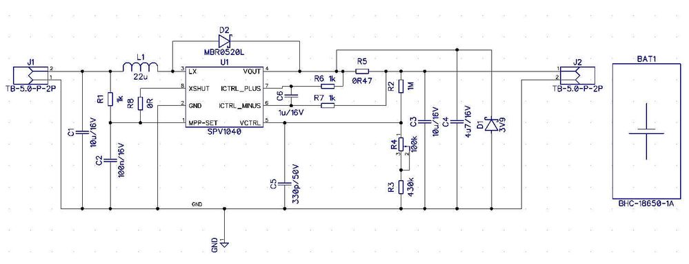

Hi.
I designed the power converter which is supply from the photovoltaic cell ( Umax = 5.5 V / 1 W) on a SPV1040. The problem is that the system did not stabilize the output voltage.The output voltage is proportional to the input voltage.
I attach the schematic:
Someone sees what mistake I make?
1 REPLY 1
elektronika
Posted on August 30, 2016 at 19:43
I forgot to add that I no soldering diodes D1 and
D2. :)
