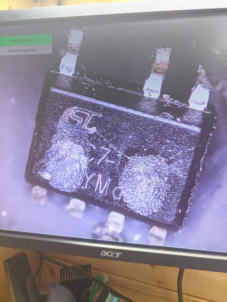

I'm a repair technician and I trying to identify a damaged component made by STMicroelectronics.
Based on the surronding components and circuitry its a PMIC/DC-DC Coverter but I cannot find this specifc one.
As you can see, all the information is visible on the IC markings is XXC7-1. And it has a 7-pin configuration on a SOP8 package.
Can you please help me identify this component?
Thank you!
Peter BENSCH
Welcome @unimatrix93, to the community!
If you look at the STMicroelectronics logo on our website, you won't notice any similarity, and it's also questionable whether the second letter is actually a T or rather a mirrored J. The logo looks like an Asian manufacturer to me.
Furthermore, the missing pin points to a driver device for high voltage in a flyback regulator, but our devices look completely different.

Peter BENSCH

You abosuletely right. I mistaken the logo with ST. So it's more likely a Flyback IC instead of a basic DC-DC converter?
Thank you very much!
Peter BENSCH
It's just a guess that it's a flyback. In any case, I have not yet seen a device where a pin was missing due to the air and creepage distances required for high-voltage applications and it was not a switching regulator for mains voltage.
Maybe there's someone else who can recognise the logo. It looks familiar to me, but I can't remember who it was.
Good luck!
/Peter

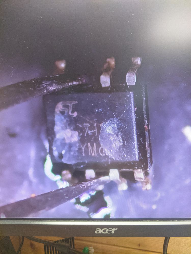

Any chance of cleaning this up and getting some better imagery?
Or the board or part# this is from?

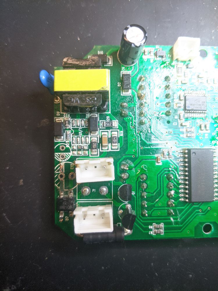

I tried to make a clearer photos of the component and the board.
Board number corresponds with the MCU of the board: HK32F03
Don't mind the other broken or missing components, all of them are identified and/or removed.
The big missing capacitor (C12) is a 400V/6,8uF capacitor, the smaller one were missing when the board arrived.
Can it be cleaned with solvent/acetone? Or another board where it's clearer, or link to board itself.
Looks to perhaps be CST, I don't recognize the logo
Perhaps something similar to this?
https://datasheetspdf.com/mobile/1418286/Chengxin/CX7131/1

Link to new photos
I uploaded the new pictures to onedrive to have a better quality. I cleaned the board multiple times with isopropyl, hope it helps.
Also, the device you sent me looks very familier to this! In fact, the pinout looks to be the same!
Maybe this is the one?
I was thinking more the IC than the board. Although if it is melted/burnt probably less so.
Any markings on the other side of the board?
This list a SOP-7 part
http://www.westech-cn.com/Upload/%E7%9B%AE%E5%BD%95/%E7%8E%AF%E7%89%B9%E6%A0%B7%E6%9C%AC%E5%8D%95%E9%A1%B5email-12270748495.pdf

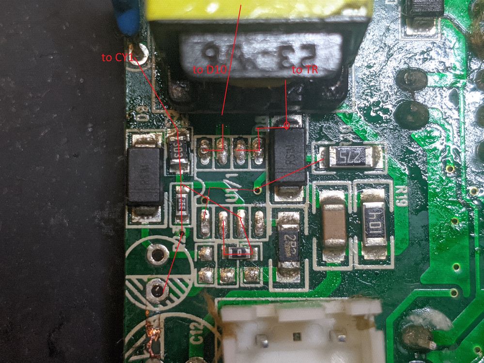

Thank you,
Only marking on the other side is "HK32F03".
Which is the marking of the MCU of the board: HK32F030MF4P6.
I'm trying to reverse engineer the pinout on the board. CX7131 seems to be a perfect fit, but not 100% sure yet.
