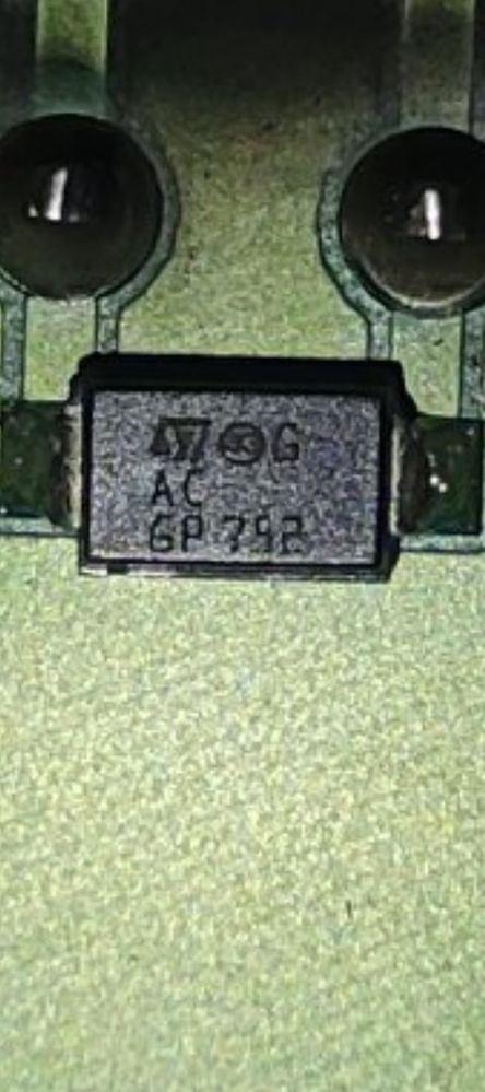

Hello, please help, I can’t identify the SMD component and its datashit, ST G AC GP 752.0693W00000WLacLQAT.jpg

Welcome, @AutoLab​, to the community!
The marking AC on an SMA package stands for the SMAJ10CA-TR.

AutoLab
Thank you very much!
