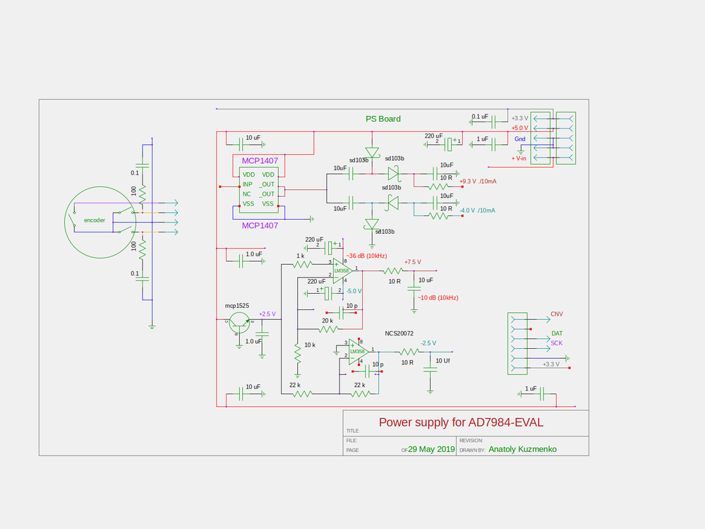

Op-amp "ultra low noise regulator" I designed for AD adc module:
