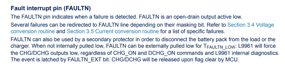

I am working with the L9961 IC for battery management, and I have a question regarding how the charging (CHG) and discharging (DCHG) FETs are turned on or off when faults occur.
From the datasheet, I understand that:
  1. The FAULTN pin is used to signal fault conditions.
  2. Specific faults, such as cell undervoltage or overvoltage, cause the IC to disable either the CHG or DCHG outputs.
  3. The IC can also latch fault conditions, and the FETs can be controlled externally.
My question is:
  • When a fault condition occurs, how exactly does the L9961 decide to turn the CHG and DCHG FETs off?
  • Are there specific registers or internal logic that determine this behavior, or is this purely based on the FAULTN pin state?
  • How can the MCU (or external controller) override or reset these FET states after the fault condition is resolved?bmsp.PNG
