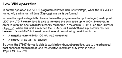

I am working on an application with wide VIN from 6V-60V and the target VOUT is 15V 3A max.
When VIN > 16V, L7987 should fit my application. Problem is that when VIN drops below 16V, eDesignSuite reports an error so simulation is not possible.
It states on L7987's datasheet that in case the input voltage falls close or below the programmed output voltage, L7987 is able to work in LDO mode. Am I correct? See screen capture of the datasheet below.
When L7987 works in LDO mode, does it mean the chip is able maintain Fsw with duty cycle lift to 100%?
What is the max. current in LDO mode?
Look forward to any comment.
Yes, but what you want then? Your 15V output can only be regulated, if Vin > 16V .
If your input is 6V, maybe you get some 5V output; for 15V you need a buck-boost design,
otherwise in 6...60V  -> out 15V not possible.
No, 92% is written there. The bootstrap cap still has to be loaded.
What you set as the current limit. Same mosfet is switching, just now at about 92% duty.

>L7987 still switch at the programmed Fsw
no, i dont think so. Because the "normal" control loop no more working, its going to some "emergency" LDO behavior, so it might do the 1us bootstrap loading on a 12/13us speed, about 80kHz.
To know for sure, you have to test it in your hardware and see, you like it - or not.
