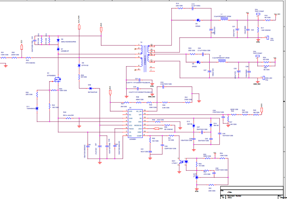

Hi sir ,
Could you please review my schematic and point out any mistakes? I am observing ripple voltages of around 2 V to 2.5 (625khz frequency range)  on both the 15 V and 12 V outputs, but I am expecting ripple levels below 1 V."
 my specifications:
           input voltage 180-275vac, output power 81w
           output voltage_1 -> 15v, 3A rating( regulated by TL431)
           output voltage_2->12v, 3A rating,
           Reflected voltage -90v
          Switching freq -53khz,fixed frequency converter.

The schematics are hard to decipher with the current resolution of 1020x706, with double the resolution it would be a bit easier to look at it in depth.
As I mentioned before, too much ripple can have many causes, the component parameters are only one of them. The transformer design and especially the layout also play an important role. And as also mentioned, such ripple can be attenuated by passive LC filters in the output lines 12V and 15V.
Hi Sir,
  Thank you for your reply. Please find the attached schematic in PDF format. I have also included an LC filter at the output, but it does not fully eliminate the noise. However, when I measure the 15V and 12V outputs using a ground spring instead of the oscilloscope’s alligator ground clip, the noise is significantly reduced, and the voltages appear much more stable. Why does this happen when using the ground spring? Is it appropriate to use a ground spring for accurate noise measurements?

Hi sir,
Thank you for your reply, Sir. Kindly review my schematic. If you would like to see the layout file as well, I am happy to share it.
After reviewing the schematics, I don't notice any major problems, just:
  • AC_OK and VFF can be derived from a common voltage divider (see data sheet, section 5.12, fig. 26), so you could combine R222...225 and R226...230 (not a mistake, just unnecessarily complex)
If you can measure better with the ground spring, an assessment of the layout is probably not necessary.
