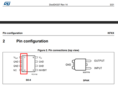

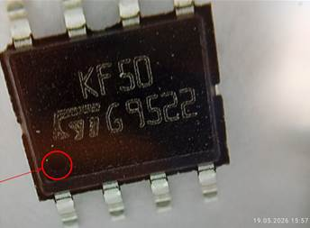

KF50BD-TR The goods have a pin indicator,but it is not shown in the datasheet .Please check attached photos.
Is the product with pin indicator original?

What about the performance? Did you see any anomaly while using it?

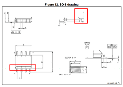

As @Andrew Neil already wrote in your other thread, on this device pin 1 is marked with a chamfered edge. The circle is only an imprint from the ejector during moulding.
Whether the component is original, you need to ask your supplier; this cannot be determined beyond doubt from a photo. If the supplier is one of the authorized distributors, they will be able to give you this information.

As @Peter BENSCH said, the pin 1 position is given by the defined chamfer on the package:
