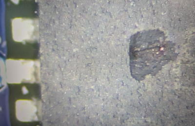

I've tested the IPS2050H short circuit protection with the STEVAL-IFP043V1 board and unfortunately it didn't go well.
Test setup according to below picture. IPD1 is connected to IN1 via 220 kohm resistor. Board powered with a 24V/15A PSU. The short circuit is introduced by inserting a connector with shortcircuited terminals. This resulted in a bang, a flash and a hole in the IC.
/Fredda

By the way, it seems like a bond wire to pin 6 (GND) has vaporized and exploded. Judging by the exposed straight channel in the crater.

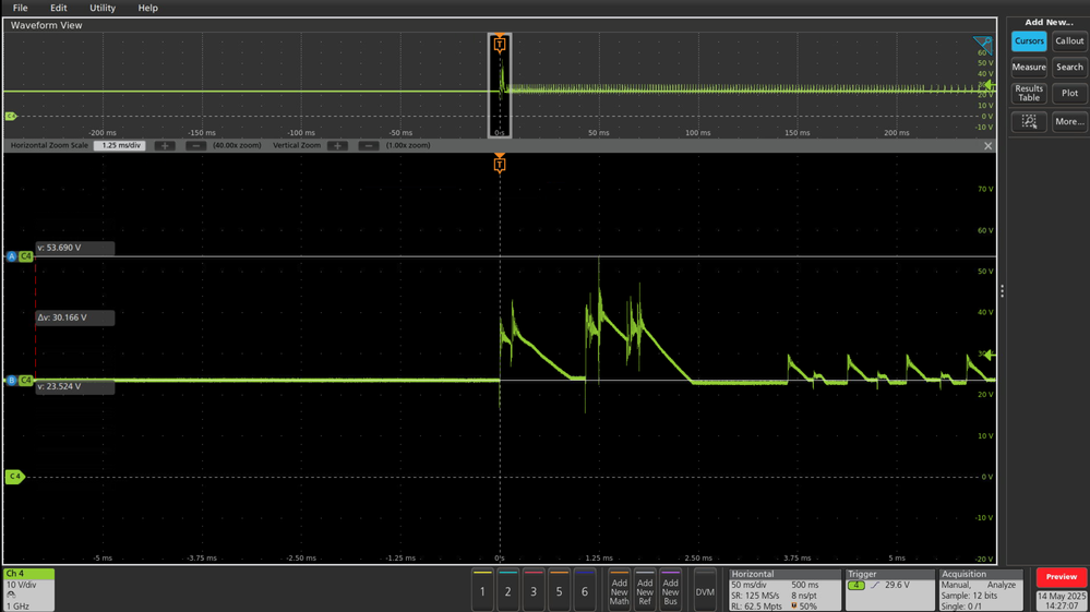

I've finally had the chance to short circuit the Power Switch with the TVS connected. It seems like the TVS is doing its job and protecting the switch from an excessive overvoltage. Great!
Short circuitShort circuit
/F
