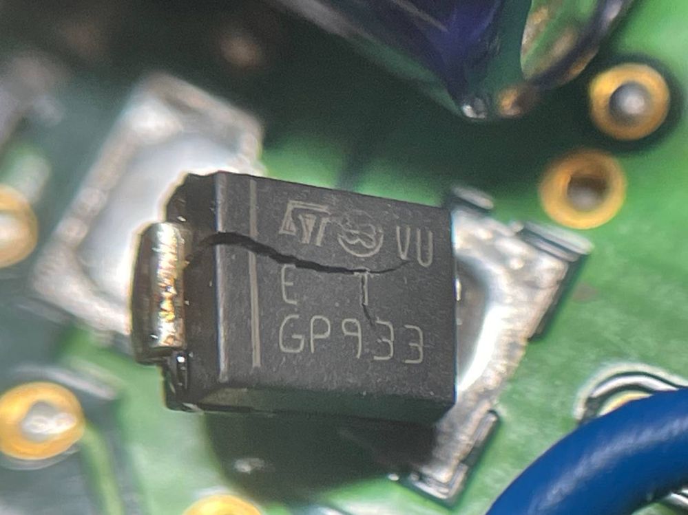

I cant identify this SMD exactly marking code & function ....v_v....
JLHK
Hello
, Bro & Sis. I’m Newbie in electronic devices repair.
one of my flashgun’s smd burned by reverse circuit.But I cant identify exactly marking code in web. Any nice guy can help??
1st row VU,
2nd row E ?
3rd GP933

Welcome @JLHK, to the community!
the marking ET, here visible in row 2 as ‘E  T’, stands for the SM6T33A.
Hope that helps?
Good luck!
/Peter

Thanks @Peter BENSCH so much ~ ,affter check the datasheet its function seem correct . I will try to replace it thanks again ~
