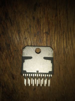

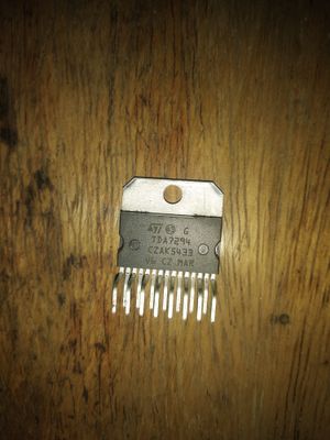

 this is the ic, No pin shorted, from tab to 1 to 12 Digital clamp meter in ohm mode shows tab to pin 1 to pin 10, 3.63 M OHM to 4.40 M OHM  13-14 from tab shows 2.80-290 m ohm , pin 5,11,12 No connection each other or from Tab, and pin 15 from tab 4.15 m ohm, Seller sold it to me by telling Original ic, positive prob on tab, all pin work like diode, if nagative prob on tab then no reading except pin 8, pin 8 only short with tab.

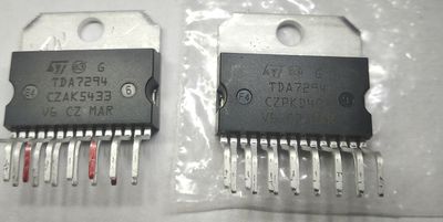

I have searched the image of tda7294 then I found multiple types of images sometimes G print on ic sometimes not, after it I'm confused that how it possible? Is it can a sign of a genuine ic?? A pic got TF print on the place of G!
If company share the details of process that how can I read the ic manufacturing date, place, batch number by watching codes on ic:face_with_rolling_eyes: :face_with_rolling_eyes: ,then I greatful to STME.

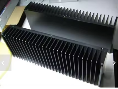

Whats the °/W  value of your heat sink ? Then easy to calculate the expected temp.
Just from my time, building power amps : for a average loss of 30W you need a big heat sink,
i used some like 300 x 80 x 40mm size ....to keep the amp under 40° . (2 x 100W amp)
These are "old" amps , from y 2003 on, produced/packed in different locations, so various labeling possible.

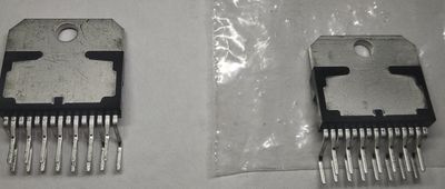

This question is for directly to ST that I had measured tda7294 and I got 5.59grams a ic in weight, a original tda7294 how much weight? Is this correct? I want answer from St stuffs who knows all about of this ic. Tell me is this weight correct? And I got two ic and print is different code and different lazer one is very deep print another one is light print,as you can see the attached pic. Both purchased from different sellers and different places. Left code is CZAK5433 and Right side is CZPKD403 is both are original??
