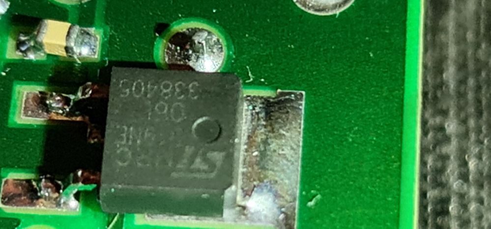

I can't find a special component to repair a device. Can anyone help me. See details and photos below. Thanks in advance.
DBENS.1

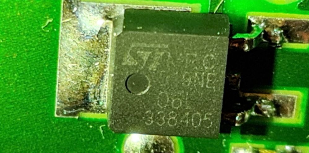

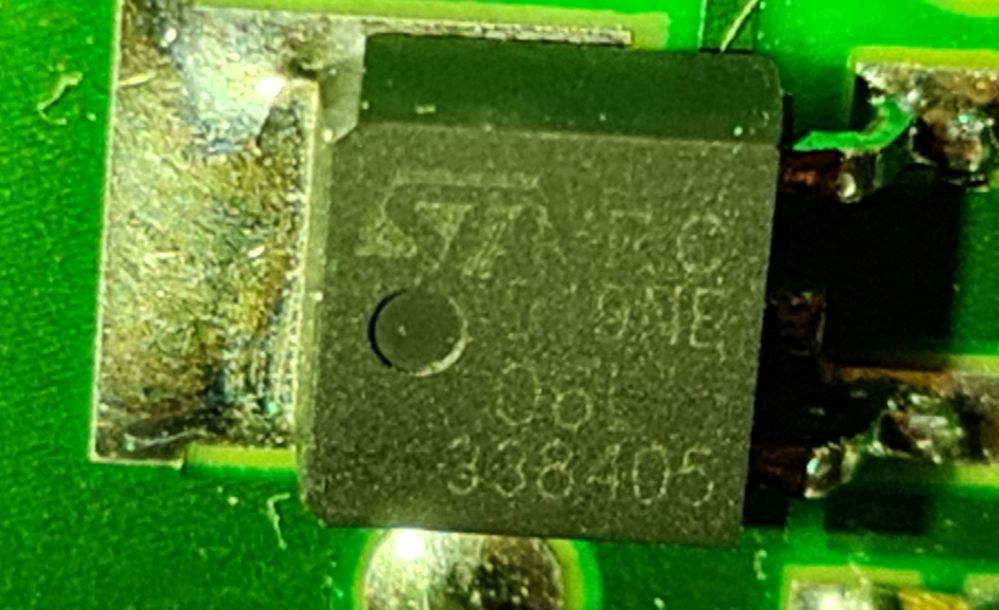

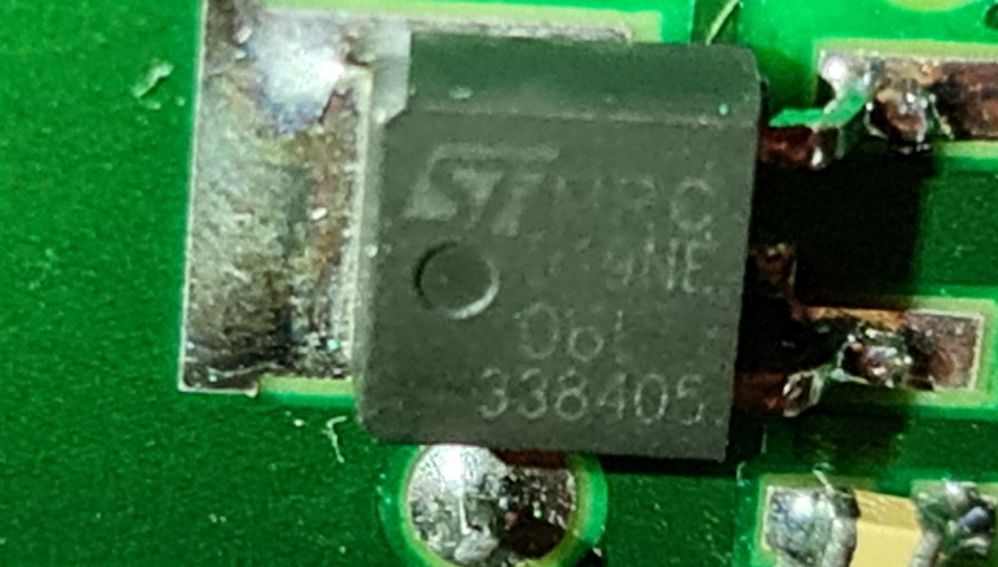

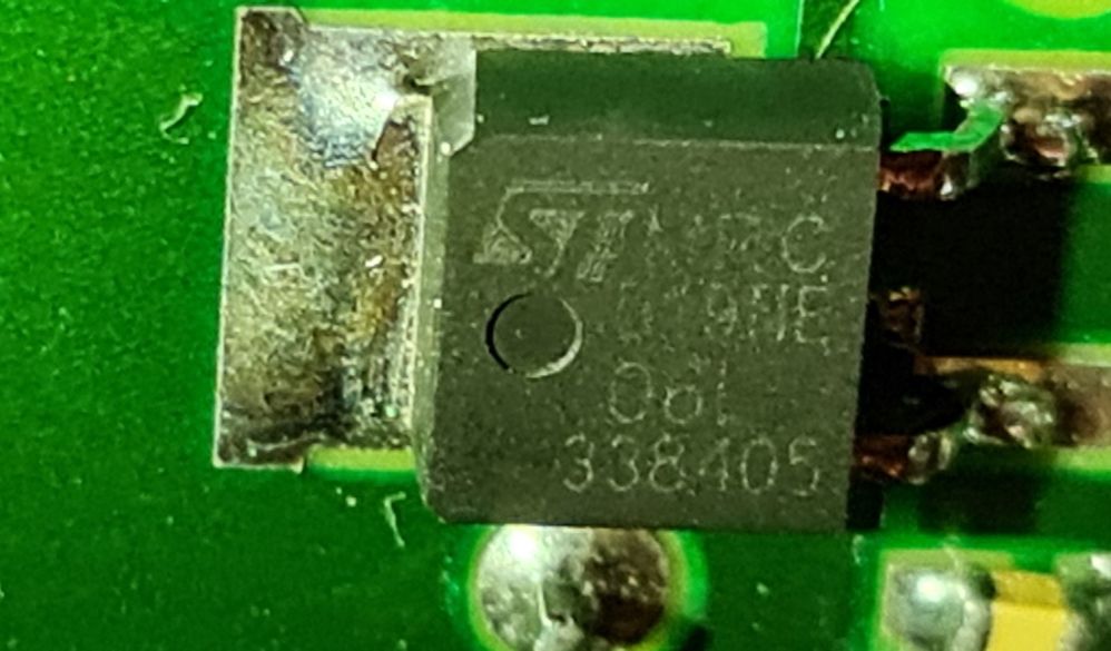

Here are pictures of the component I'm looking for.
This comes from a control board for a rear light (Led) from an Aston Martin DB9 - 2005.
There are 4 on the board and one of them is burnt.
I can not find this component in the trade and impossible to find an equivalent.
0693W00000FDtV0QAL.jpg0693W00000FDtUbQAL.jpg0693W00000FDtU7QAL.jpg0693W00000FDtTdQAL.jpg

It was the STP19NE06L, an n-ch FET in DPAK, 60V, 24A, 40mohms (max), 13nC, meanwhile obsolete:
https://www.st.com/en/power-transistors/std19nf06l.html
You might consider the STD25N10F7 as a replacement:
https://www.st.com/en/power-transistors/std25n10f7.html
Good luck!

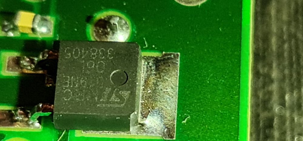

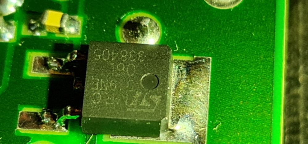

Rotating the pictures could help somehow. Writing down what you decipher would help more.
Thank you for your answer.
I can read only part of the reference :
MFC or NFC or MRC or NRC
19NE 06L 338405
0693W00000FDupQQAT.jpg0693W00000FDupBQAT.jpg0693W00000FDuohQAD.jpg0693W00000FDuoIQAT.jpg
Uwe Bonnes
Principal III
the picture at https://www.ebay.com/itm/224227338361 match partial.

Hi Peter,
thank you very much for your answer.
Your informations are very complete and they will be very useful to me.
I will immediately order the component.
