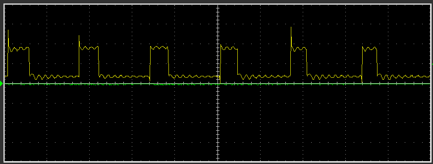

Posted on June 07, 2017 at 21:17

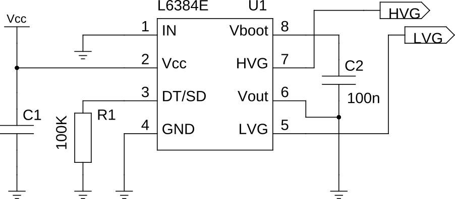

Hi, i'm having the same kind of problem with the L6384E. I'm using 12V on the Vcc, do you think it should works?
The strange thing about my aplication is the Vce, the voltage on Collector e Emissor doesn't get steady. As shown on the image.
