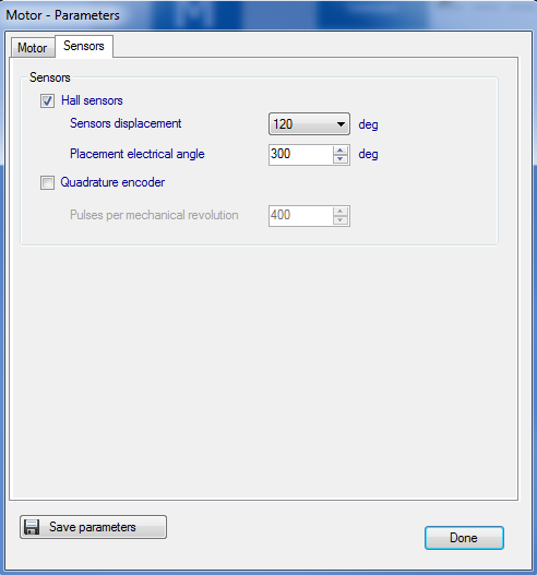

Posted on April 24, 2018 at 12:22
Hi Abdul,
in case you are using the
/external-link.jspa?url=http%3A%2F%2Fwww.st.com%2Fcontent%2Fst_com%2Fen%2Fproducts%2Fembedded-software%2Fmcus-embedded-software%2Fstm32-embedded-software%2Fstm32-standard-peripheral-library-expansion%2Fstsw-stm32html
version, the UM1052 document contains the right info about it, for instance for Hall sensor take a look at ''8.3.3 Setting up the system when using Hall-effect sensors''. Consider that the parameters calculated must be filled in the ST Workbench tool (see image attached) in the section ''motor'' and select the settings in ''drive management->speed position....'' section.
Best regards,
Giuseppe Scuderi
Posted on April 24, 2018 at 12:29
The FOC library supports both sensorless and sensored motor, you can use the ST Workbench tool to configure the IHM08M1 for Hall or Encoder mode.
